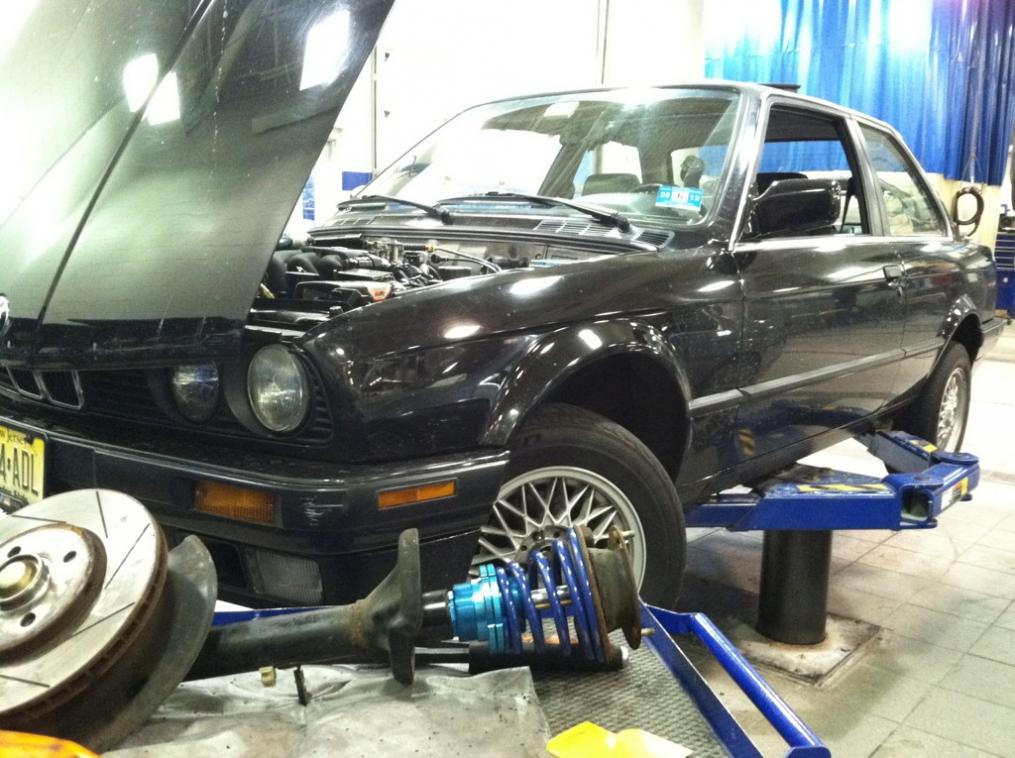

    This is a pic of when I had the collars about half way down for the initial trial. Yesterday I spun them all the way down to the bottom before they spin off the assembly.???[ATTACH]57452[/ATTACH]
    I think you have the threaded adjuster upside down. You spring shouldn't be nearly that compressed. Take it apart, cut off the factory spring perch, put some rubber o-rings on (trust me, you'll love this when you go to adjust it), and slide the adjuster with the open end down over the strut tube. If you already did all this then idk what's up.

    That sleeve should go down into the stock spring perch much further. It may need to come off again. It looks like the outer sleeve that the spring sits on is not down all the way down on the threaded sleeve goes into the stock strut tube. Its been so long since i installed mine i don't quite remember. IIRC i had something on backward and after i installed the upper strut mount it looked similar to yours and i had to take it all apart and figure out what happened...

    This is a pic of when I had the collars about half way down for the initial trial. Yesterday I spun them all the way down to the bottom before they spin off the assembly.???Click image for larger version

    Pics of the front setup? I'm pretty sure you did something wrong...with my fronts all the way down I can lean my phone sideways on the lip (although my tires are small).

    My ride Height is wacked out I'm about half way on my collars in the rear and all the way down on my front... Click image for larger version
