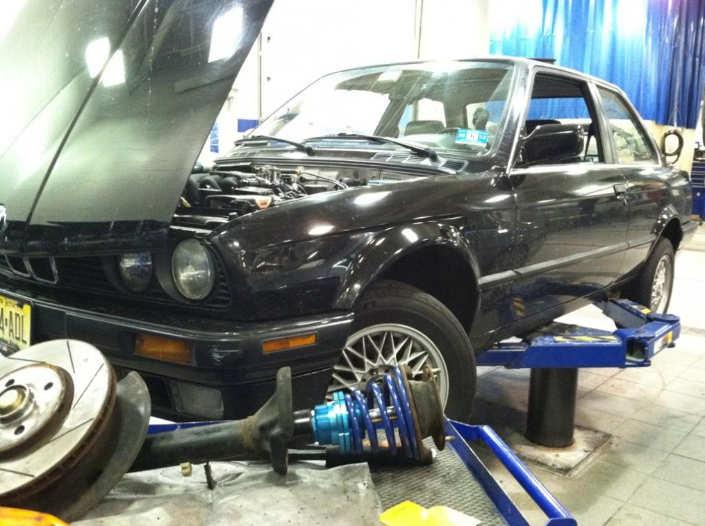

  • Tree25
    replied
    Cut off perch Click image for larger version
    Make sure to get rid of any surface rust, etch prime and spray bomb
    I think it's a good idea to splurge on some lithium white grease to make adjustments easy in the future

  • Tree25
    replied
    Originally posted by Vivek
    I think you have the threaded adjuster upside down. You spring shouldn't be nearly that compressed. Take it apart, cut off the factory spring perch, put some rubber o-rings on (trust me, you'll love this when you go to adjust it), and slide the adjuster with the open end down over the strut tube. If you already did all this then idk what's up.
    Once I cut off the perch, where should I put these O rings? I'm not sure exactly what you mean by this, but if it makes my life easier I'm all for it.
    Leave a comment:
  • Tree25
    replied
    I definitely did this backwards... I'm pulling it back into my shop and flipping it. I should be an expert at this by now (chuckle). Thanks for the replies.
    Leave a comment:
  • be34st
    replied
    +1 ^^ upside down adjuster. I did the same thing with mine the first time.
