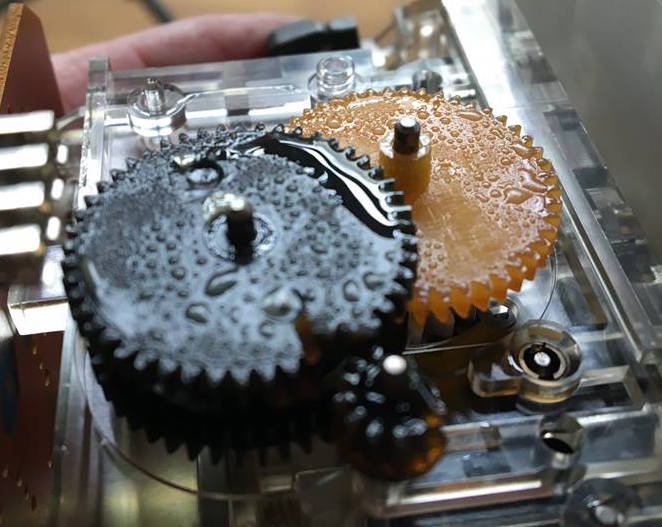

                          Garagistic for the win!
                          I only learned of Garagistic after a friend told me about them (he also told me about this great forum). It's awesome to finally find these gears at a reasonable price! I had been putting it off for a long time because I couldn't bring myself to spend $75+ for 3 plastic gears, but jumped when I found them on Ebay for $18.50 shipped several months ago.
                          My gears were in pretty bad shape:

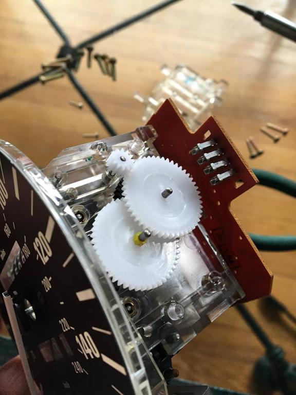

                          I read about people having a hard time getting the brass bushing off the drive pinion, but it came off surprisingly easily. I simply crushed it lightly from several angles with a small pair of wire cutters and it slid right off. The hardest part of the whole deal was getting the tiny spacer on, but wasn't a big deal.
                          Here are the new gears installed
