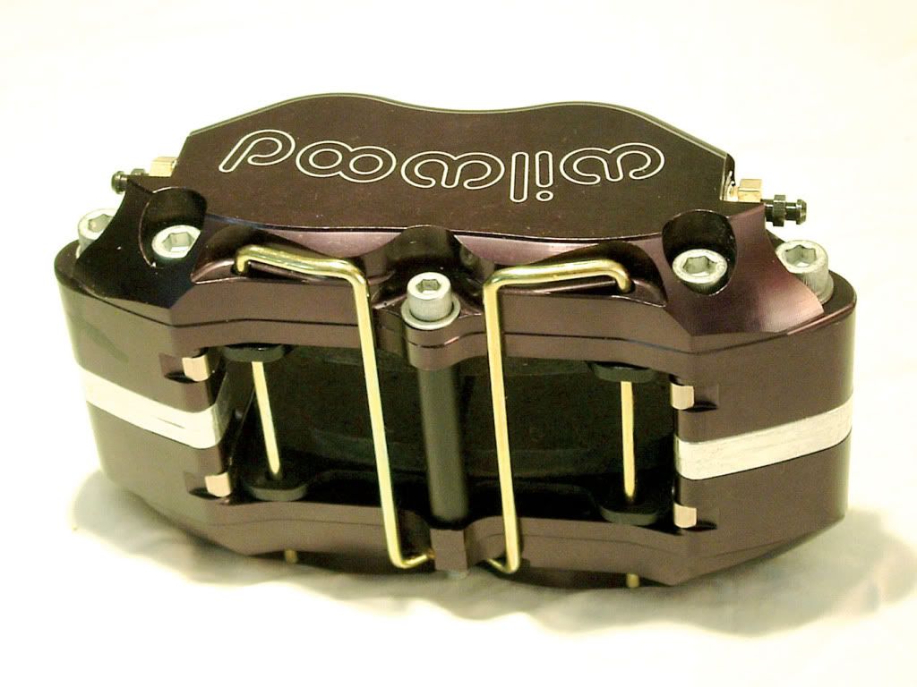

    "For additional strength all DP calipers can be fitted with a center bridge bolt kit to provide even greater resistance against body separations under high load. Center bridge bolts are included with all side inlet "SI" models and available as an upgrade option on all other models."
    Make sure you order the bridgebolt option. It does stiffen the caliper. That is what is supplied with the complete kit.
    Z31maniac, the BP20 pad is a medium friction street pad. It can widthstand high temps, but it will not have the longetivity for tracking. What is your car's duty and what's under the hood?

      ^On the bridge bolts, let's say you've already ordered the calipers, I'm assuming we can upgrade ourselves since it is listed as an "upgrade option?"

        I suggest you start with the BP20s you already have, and then see how they work. On the long run, you may want some "B" or "C" compound for the track. The long bolt and aluminum sleeve can be ordered separately. Contact the source from whom you purchased the calipers.
          I just got off the phone with wilwood and the rep told me dynapros wides dont have a center bridge bolt option.
          Lee: Is the rep on crack or are you still using dynalite's?
            Damn liberal California reps. Still on weed. Look at the picture of the calipers I sold a few months ago within the GB. It is called the SI option. I wouldn't sell a complete Massive kit without that option. Feel free to share with the Wilwood rep. If Wilwood doesn't want to sell them, despite being advertized on other website, then I suggest you buy the calipers directly from my partner in Wisconsin. They are in stock, with bridgebolt.
            Email John Robertson and deal directly with him: emerymotorsports@gmail.com
            Mention I sent you for the bridgebolt option. I remember it was my requirement toward Wilwood. Maybe they bent over just for me.

              Yeah he told me that SI for the 120-9703 only moved the inlet... Damn sales reps.

                        copied from the wilwood site:
                        Description of WILWOOD 120-9703The DynaPro is loaded with other enhancements for performance and wider application. The calipers feature Quick-E-Clip pad retainers that support a 7812 type brake pad from the top. Not only does it allow for fast pad service without caliper removal, the bottom pad supports have been removed to create a slimmer profile that can be more easily fitted into tight clearance applications.
                        Heavy wall stainlesss steel pistons are used to resist corrosions and slow the heat rransfer from the pads. The heavy wall sectional thickness also provides additional strangth against backside deflection to provide a firm pedal feel and efficient clamping, even at the high pressures generated by power boost systems.
                        Each DynaPro is also fitted with Wilwood exclusive SRS bridge plates. SRS plates eliminate the bridge wear caused by pad gouging to extend the service life of the caliper body. The spring-loading action of the SRS plates also eliminates pad rattle and dampens the vibration harmonics that contribute to squeal during engagement. The package is completed with internal fluid passages and four corner bleed screws that allow mounting in any front, real, left or right side position.
