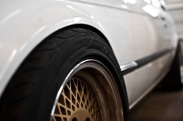

                            a quick offset lesson to back up my "adapters for style 5s" claim: here's a car using full e36 (325is/318ti) 5-lug suspension and ground controls running 15x7 et20 wheels with 205/50s.
                            the front wheels poke out of the fenders, and the fender is sitting down on the tread block. if you were to run 18mm design 2 4x100 > 5x120 adapters on these wheels you'd be at 7 et2, which on an e30 with stock 4-lug would be around 10-15mm further in than this.
                            on top of the fact you spent way less money and time getting the wheels on there...they fit way better, you're way less committed to the wheels should you decide to change, and you've still got the freedom of choosing from both 4 AND 5-lug wheels in the future.
