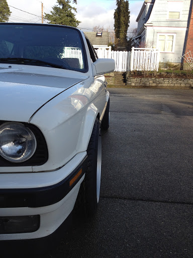

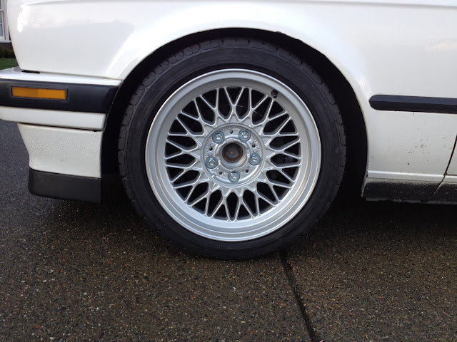

                        Originally posted by slowe34
                        Got mine yesterday and mounted up!
                        Took a bit of time to get the first one on, but once I figured out how to get that kidney thing lined up it was a breeze.
                        mmmm style fives
                        whats size are those wheels?
                        • 8380 Labs
                          • Oct 2006
                          • 2990
                          #207
                          Those are 16x8 et20 with 205/45s.
