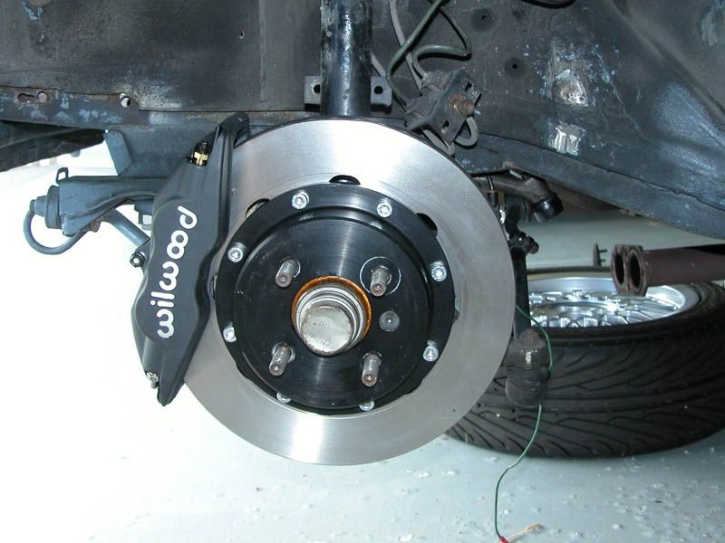

                Picture from a 12.2" kit taken from FastBrake's website (free plug).
