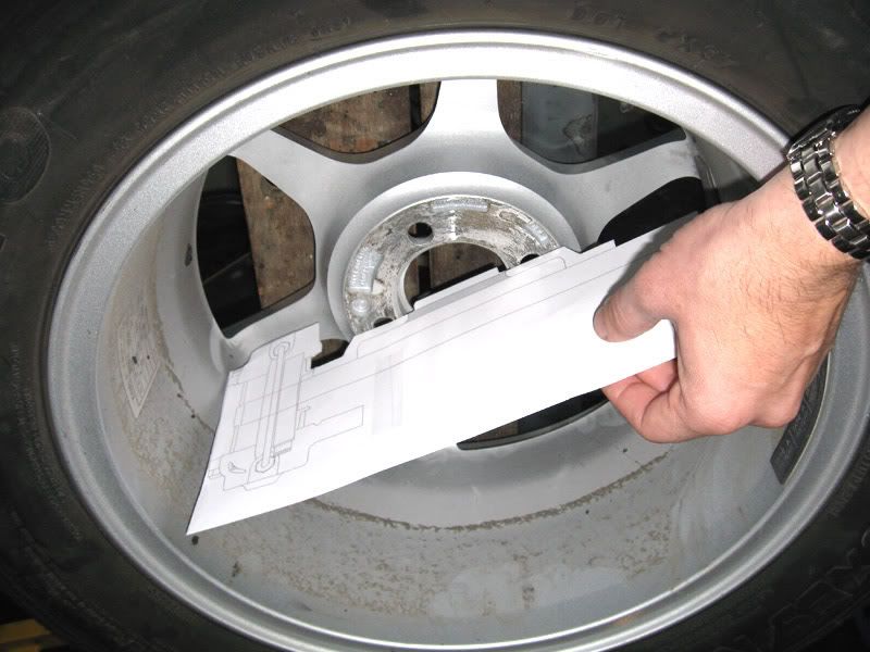

    BBS RS wheels are usually very flat inside, which do not yeld much room. In order to make sure, please email me at massivebrakes@gmail.com and I will forward you profiles for:
    - 11.75" x 1.25" race kit with Superlite
    - 11.75" x 0.81" street kit with Superlite
    - 11.75" x 0.81" street kit with NDL
    - Superlite vs NDL
    Using those profiles is the only way to make sure a kit fits. here is a picture depicting how to test a profile on an SSR Comp wheel. The kit profile being tested is the one for street kit + Superlite. Clearances are pretty tight and replacing the Superlite calipers with Narrow body Dynalite would prove a better solution.

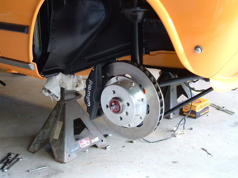

              • blunttech
                • 12850
                #52
                not that lee needs it but i have a set of these on my 02 and quality is top notch as is customer service. i had many questions during my install and lee was willing to talk me thru it both in emails and on the phone. im excited to see your success lee. keep at it

                • Massive Lee
                  • Sep 2006
                  • 6785
                  #53
                  Hey Blunt. How are you? Guess what? I found a local M3 with a slight dent on the nose that the owner (a car broker who has three others) will let me have the S14 motor to fit in my own 2002 racecar. It is supposed to be a low mileage too. Back to topic. The picture indicates you opted for the UL rotors instead of the HD. It is also a good choice as those UL rotors with directional vanes are more than enough even for an all out racecar. I did two seasons on a set of UL. I can also see that you have the batch of kits I made a year ago with the stainless steel domed head bolts. I reported to my fastener supplier afterward that those bolts were a bit out of specs as their overall diameter was perhaps 0.1mm too big. Which is why for this batch only, inserting the bolts needed a bit more care. Like pushing the bolts by hand instead of letting them drop in the holes.
                  Anyway, it is nice to see another 2002 with enough brake for a 540i.

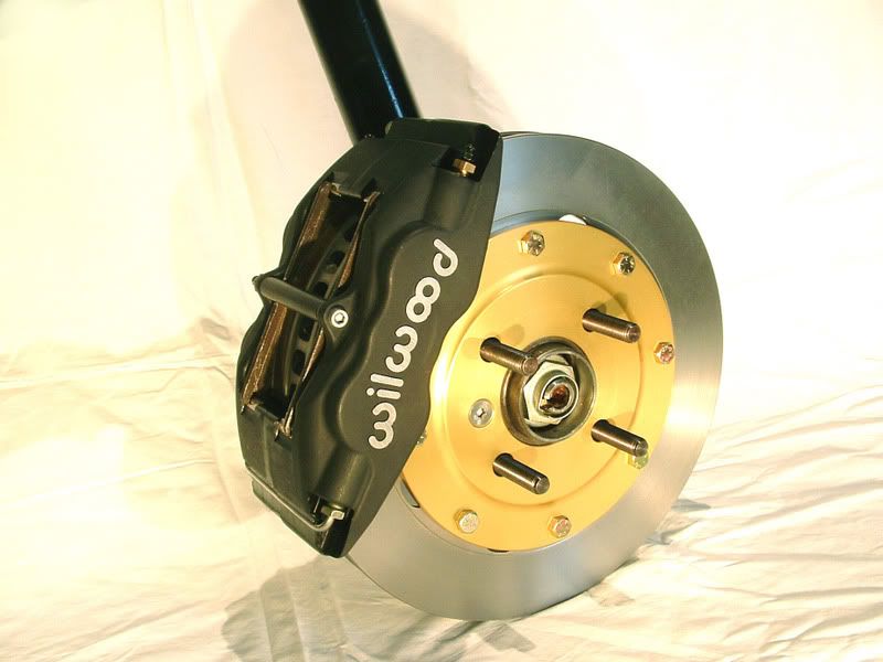

                  • Massive Lee
                    • Sep 2006
                    • 6785
                    #54
                    More pictures of the e30 race kit with Superlite forged calipers.
                    Before installing the two-piece rotors on the hubs, carefully clean the hubs with a wirebrush to remove any rust. Depending on the brand of your hub, the hat may need a certain pressure to slide. This is normal. All the parts are made with very tight clearances. With time, it will slightly loosen up. Clearances are so tight, to ensure any unwanted vibrations, that you may even have to cool the hats in the freezer before installing them on your rotors which should be at room temperature. When racing, the aluminum hats, which expands a bit more than steel, will perfectly keep the rotors centered, nut with the bolts but thanks to a ridge that holds the disc in its center. This is the reason for no vibration under any condition. This proprietary design (currently in the long and costly patent process) is what makes the kit trouble-free, safe and easy to run.
                    The only mod to the strut is to cut the small tab for the backing plate. An angle grinder with a cutting disc will take 3 minutes of your day to do this clean mod.
                    Mate the bracket, stainless steel spacers (between bracket and caliper), caliper and washer, using the 12.9 graded countersunk bolts and Nylock nut. Tighten to 75-80ft.lbs. Then slide the assembly behind the strut's mounting ears. Adjust caliper height depending on your pad. Tighten to 80-85ft.lbs.
