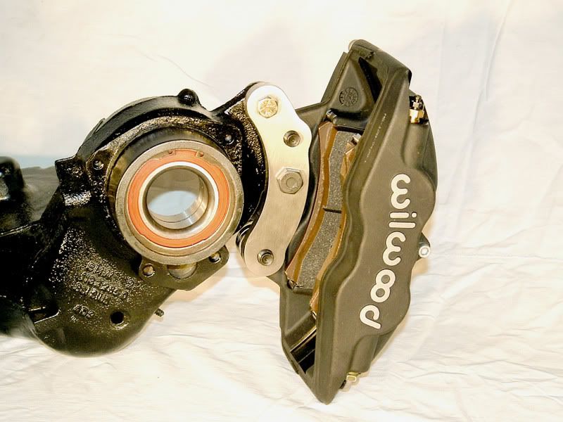

      I am currently developping several other projects, including rear 11.75" x 0.81" brakes for e30s (I already have a rear kit for e30 M3s with huge 12.2" x 1.25" discs). The rear ee30 M3 kit comes in two flavor. 4 piston radial mounted 4R/ST caliper ($$$$$) or more affordable 4 pistons lug mounted Superlite forged caliper. here is a development picture. Note that those are not the proper fasteners.
      With radial mounted caliper. In this photo only, using an SL6R for prototyping.

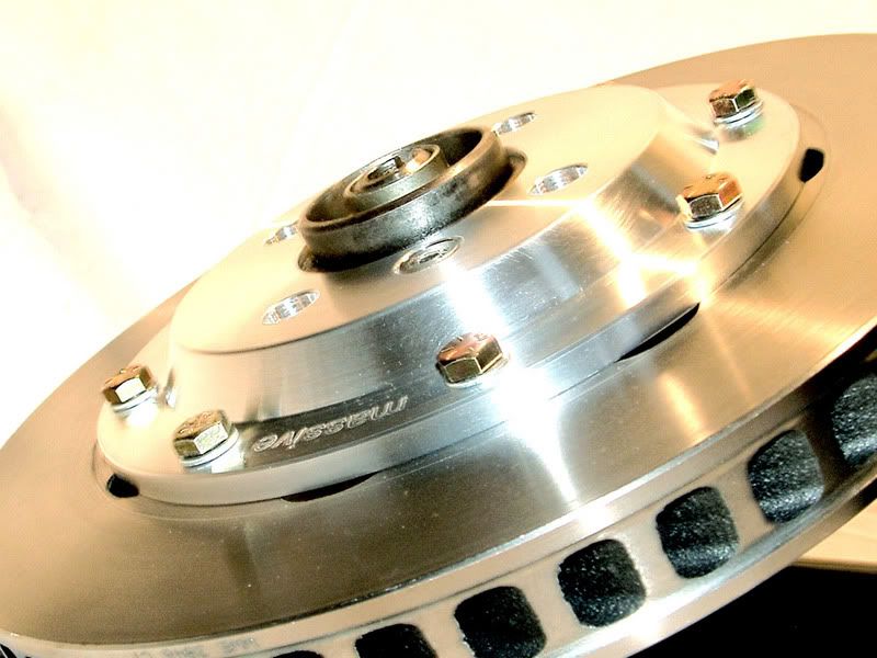

                        Here is a close-up shot (before being sent to anodizing) of the hat for the e30 street kit. It is deeper than the race kit. Obviously, it is the wrong rotor that has been shot as I did not have anymore of the slimmer 0.81" street rotor. It is not possible to install the thick 1.25" rotor on the street hat as it would contact the strut.
                        massivebrakes.com

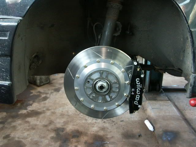

                            Quick question that we want to check first (before ordering):
                            - would your 325 race kit clear a strut with the H&R Cup kit? (we had some clearance issues with a few wheels that we were able to solve by using a small spacer, but we cannot spacer the brake kit).
                            We have some pictures of the actual installation of the kit on our car here:
                            I think the first and last picture should help.
                            Hope you can help?
                            BTW the kit is cheaper in this topic than on your site - coincidence?
                            (trust a cheap Dutchman to notice this...)

                              Hi Tom.
                              if your H&R struts have the same specs as the stock struts (which they should have) then the thick disc will clear the steering ball joint's boot by about 4 to 5mm. If you race, I suggest that you bent a tiny piece of stainless steel or aluminum, and make it a heat shield to protect the rubber boot.
                              300mm x 32mm is more than enough for a race car.
                              Pricewise, the quoted prices on r3vlimited are a temporary promotion until end of February. So, just let me know if you prefer to pay the forum's lower price, or the regular website price...
                              If you are in the Netherland, I can only ship (for now) the installation kits. You must order the calipers/rotors/pads from RallyDesign.co.uk in Great Britain. They are too heavy/expensive to ship from North America, until I find a cheaper way. If I had a European agent, then I would simply ship a whole pallet of kits and rotors/calipers for $500. Individually, cost is $250 for a whole kit, or around $105/$110 for the installation kit.
