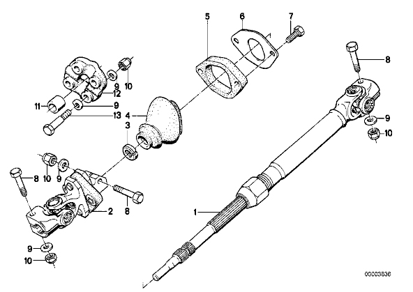

                  #38
                  Air bag cars.
                  I have an air bag car and the original u-joint goes right on the pinion spline with no additions or alterations. It does move the shaft to the right and down a bit where it comes through the firewall.
Name:	E30 PS Column.jpg
                  #6 needs to be cut out a bit for the rubber seal(#4) to fit. It's easiest to remove #6 before the rack is installed. Loosen the big nut and slide the shaft(#1) out, then unbolt #6. The bottom of the oval opening needs to be cut out so the opening is rotated about 30 degrees to the center of the car. It's a lot easier than it sounds once you get in there.
                  The angle of the pinion housings on E36 and M3 racks move the lower joint toward the center of the car compared to the E30.
