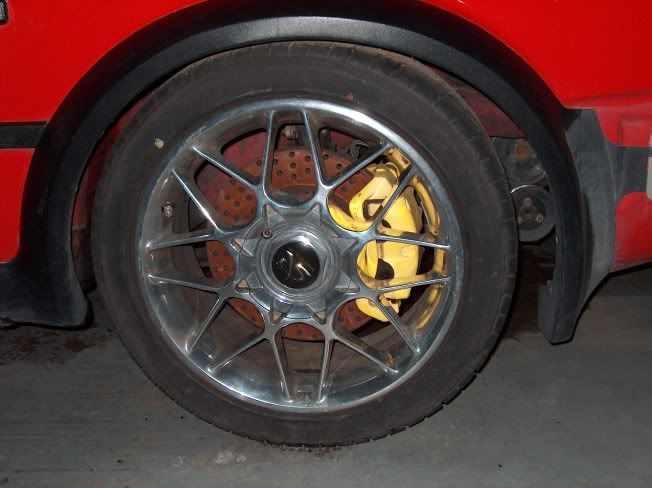

            what about the ATE rotors? reg or atom slotted.
            i ran those on my jetta with no problem as a big brake upgrade using Audi turbo quattro 2 piston calipers
            this the only pic i have unfortunately. they ARE ATE rotors just way over cross drilled experimental stuff that didn't work. IIRC the did not have the rotor hat holes though
            seien Sie größer, als Sie erscheinen

                i wasn't implying that you would. those were drilled after the fact, and WAY too much at that. funny though, when i did the brake conversion on my jetta the rotors didn't have the openings in the rotor hat. that was 10+ years ago though. things must have changed since then.
                what about a blank Audi TT rotor? that was my next brake upgrade i was going to do on the jetta. they are 13" though. that might not work for what you are trying to do. just a thought

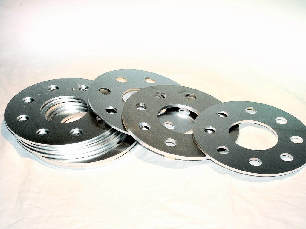

                    Okay. Here is a posible rotor. It is pricier than the base rotor I intended to use, but I opened a wholesale account and can work on prices. That disc has slots, and comes vented from the back, allowing to use cooling ducts. Do you think that if I included free 3mm aluminum spacers in the introduction offer, you guys will open you wallet a bit wider?
                    The question now is:
                    For $600 GB price - I offer a blank rotor with outward vanes - $660 regular price
                    For $650 GB price - I offer a performance rotor as pictured below - $720 regular price
