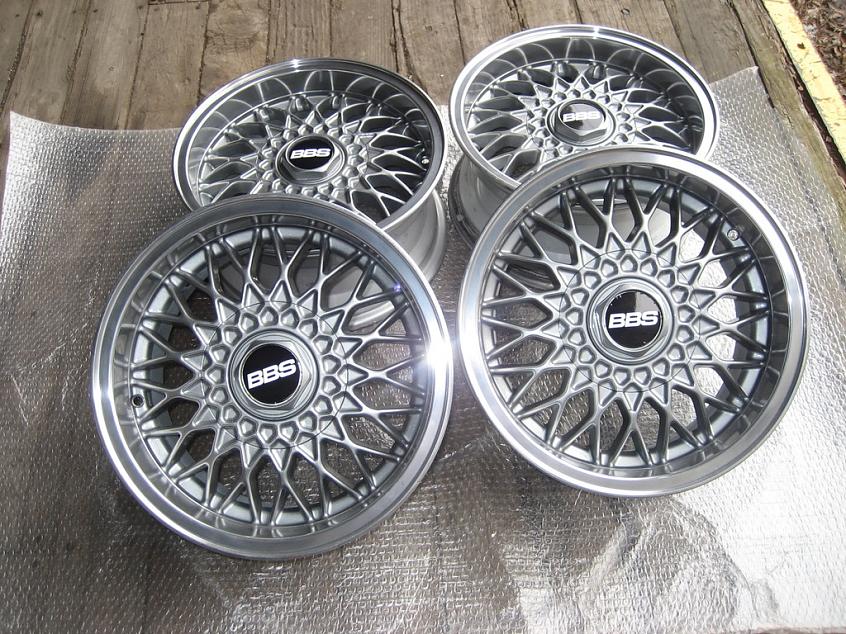

                    #69
                    Works with most 15 inch? I have a bbs...not sure of model type but it's got a pretty big lip. Here is a pix of rim if that means anything. I think I want kit minus my one tie rod issue..
                    dlm ny

                      #70
                      Have you used the measures on the first page? Have you tried the profile in pdf form? Wheels with wide lips, often have flat face backs. You need 23.8mm + 3mm from the hub to the back of the spokes.
                      Very difficult to know what wheel will wor or not, just looing at their face .
