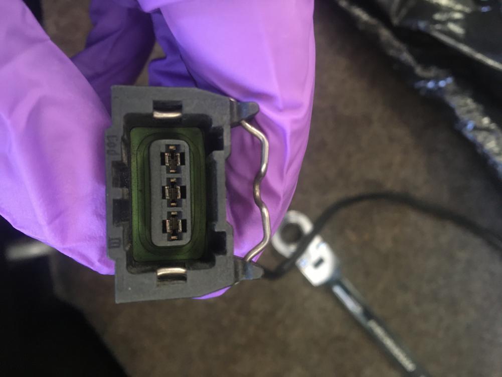

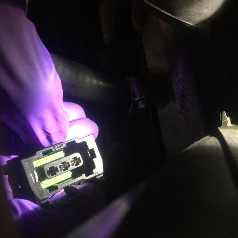

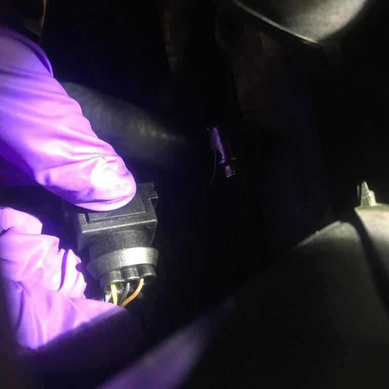

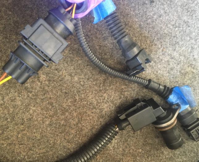

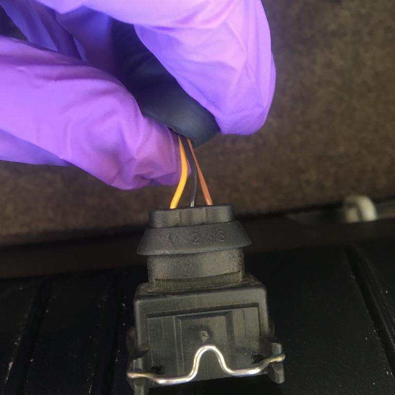

    I purchased a brand new 99 S52 harness from ECS tuning and I am trying to connect the Sub-harness into the main harness but the connector is incorrect I believe. The Sub-harness connects into the Crankshaft sensor, aswell as the Camshaft sensor and it plugs into the vanos. Has anyone had this issue? From what I see the brand new harness I have is using a "code 2" labeled connector. I compared this with the old harness that I had which does plug into the Sub-harness and it uses a "code 3" labeled connector. Seems like they made a mistake from factory? I don't see how that would be possible but both connectors on each harness are 3 pin with brown, black, and yellow wire colors. I am under the impression that this Sub-harness is 100% needed to run the vehicle because it was introduced as a recall to fix the Crankshaft sensor issues.
    In the photos you can see the slight difference between the two connectors.
    Can anyone look at these pictures and confirm this for me? My plan is just to take the old harness connector and splice it onto the new one so I can use the Sub-harness but I wanted to get some feedback.Click image for larger version  Name:	Newconnectorlabel.JPG Views:	0 Size:	42.1 KB ID:	10017693
    (1) new harness "code 2" connector
    Click image for larger version  Name:	Oldconnectorlabel.JPG Views:	0 Size:	51.5 KB ID:	10017695
    (2) old harness "code 3" connector
    (3) new harness wire colors
    (4) old harness wire colors
    (5) old harness plugged in

    UPDATE:
    The Sub-harness is not needed on a brand new S52 wiring harness from ECS Tuning. The harness has the crankshaft connector on it. I Plugged the Vanos into the injector harness and the car started right up. I definitely was overthinking this one and thought I needed that sub-harness for sure but its not needed for a brand new harness from factory.
    Hopefully this helps anyone that was stumped on finding out for sure if they needed the Y harness/ sub-harness. I have been trying to figure it out for weeks hahah. If your harness has the crankshaft connector directly on the main harness you do not need it, if it has the camshaft but not the crankshaft than you use the Y harness used in the recall.
