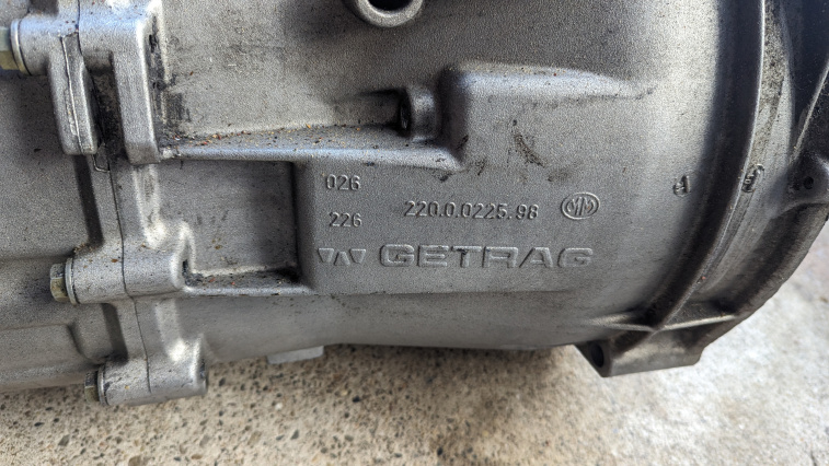

    I have a getrag from what I thought was a e36 325i. With that I've read that I can use the stock transmission cross member but it doesn't seem to sit right. Is this because my engine isn't sitting correctly or do I need the cross member for the e30 10 degree offset transmission?

    Also this is my transmission part number
    95 M3 - Powerdyne supercharger, WAR Chip, Ground Control Track/School coilovers, Eibach Sways, Dinan Exhaust, UUC SSK

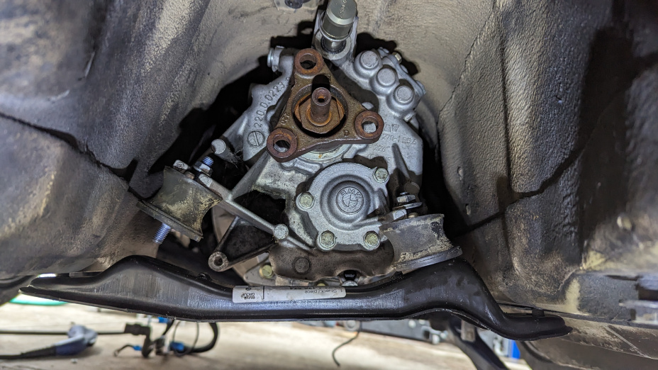

          Indeed!
          Photo from my 1987 M20B25 with 1986 Getrag G260 (pulled off the back of an M20B27)
