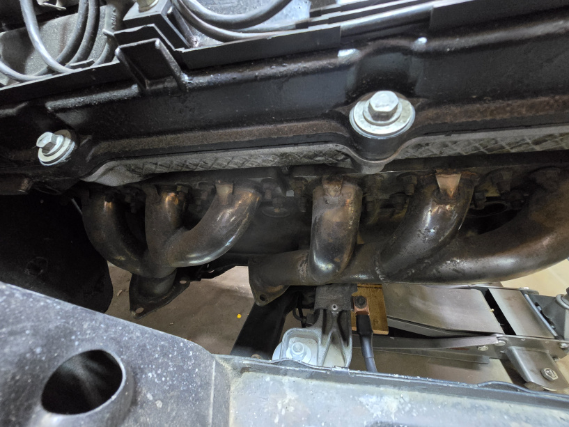

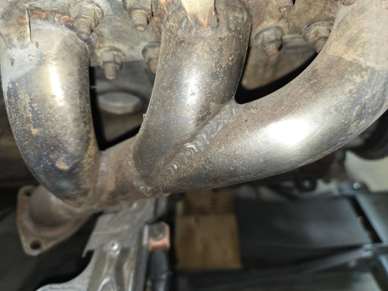

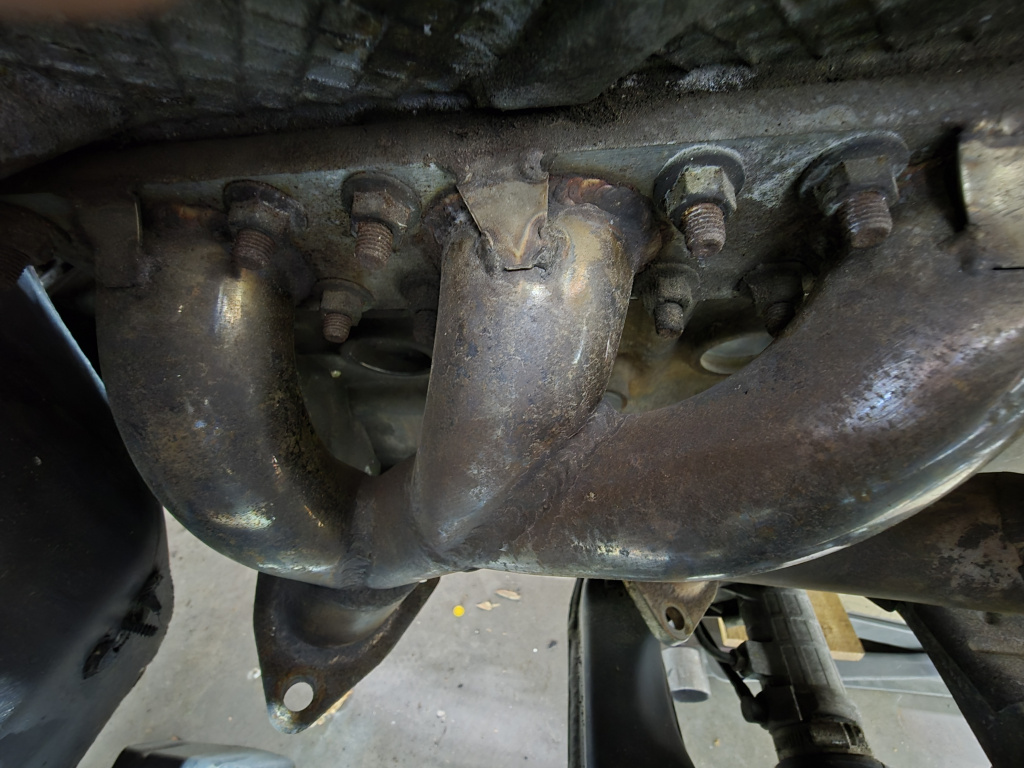

    Current manifolds if this helps

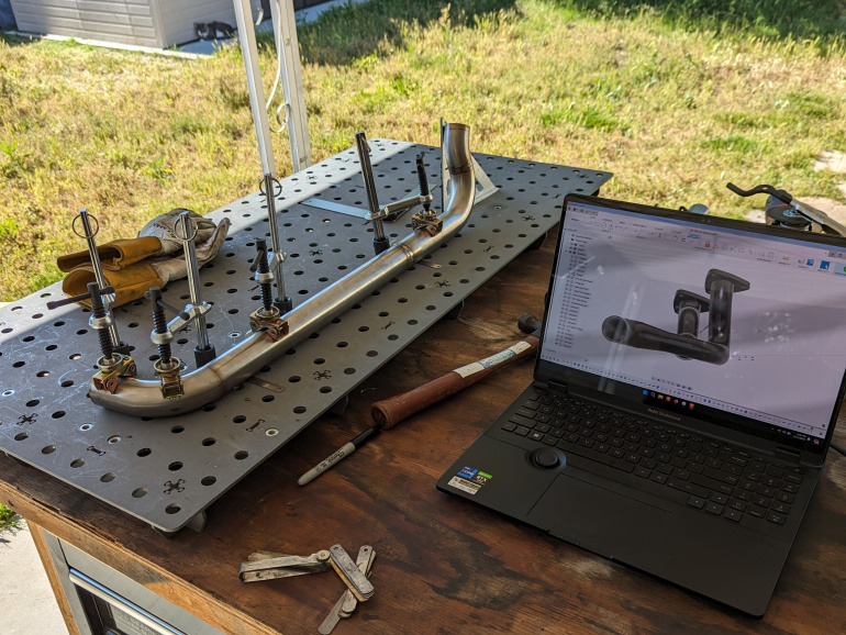

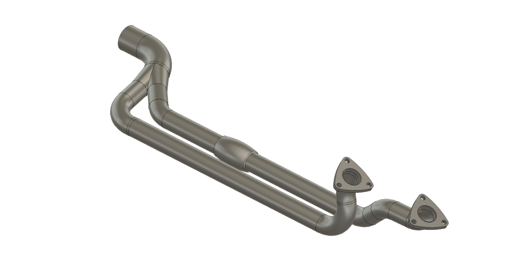

      I am currently building a set of downpipes, one for a buddy of mine, and more to hopefully sell. I built my exhaust when I swapped the engine a few years ago, and now I'm revisiting the idea of building more. I 3D scanned my original exhaust and built a 3D model, so I could reproduce it. Since I'm not done yet, I haven't advertised it yet, but since you asked, I thought I'd let you know!
      It does require the use of stock OBD2 manifolds.
      Fully 304 stainless steel, TIG welded and back purged, all mandrel bends. 1.75" primary tubing, joined to either a 2.375" tube to be mated to a Magnaflow cat, or 2.5" single.
      The goal of the design was to closely match the length of the runners from the front and rear manifolds, to be easy to install (by giving the maximum amount of clearance from the pipe to the subframe while maintain smooth flow), and allow the use of stock LCA lollipops. I have also incorporated a flex joint, and yes, one O2 bung after the merge.
      As mentioned, I have been running basically this on my own car for years now, with no problems. I just need more time for a production-ready model.
Name:	E30 24v exhaust1.png
      The 3D design
      The work-in-progress
      If you're interested (and can get stock manifolds), message me for a price quote.
