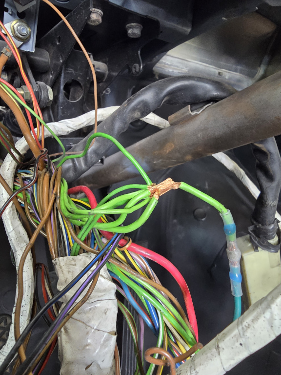

        Started tracing wires and found this.. doesnt seem very factory to me.... and they all have 12v with no key
        the patch piece goes to one of the green ignition wires

          oh wow, you have some troubleshooting to do. Find out why this was done in the first place. Were they trying to hook up an accessory to constant power? A wideband controller perhaps? Alarm? it's usually something aftermarket.

            It had a viper alarm in it... Im guessing the alarm spliced here.
            2 of the green wires go down to blue cluster plug and warning light. 1 goes to ignition switch(the one with heat shrink).
            Should these cluster wires li out at the big C connector that runs into bay?
