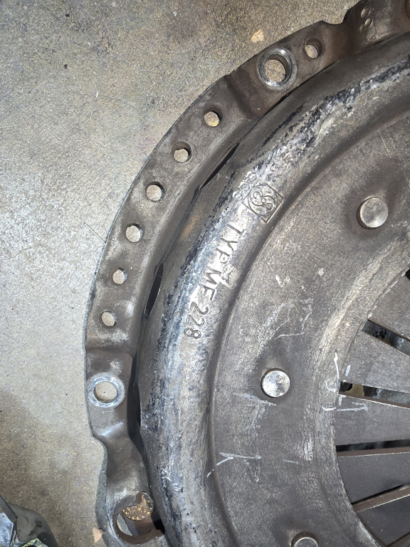

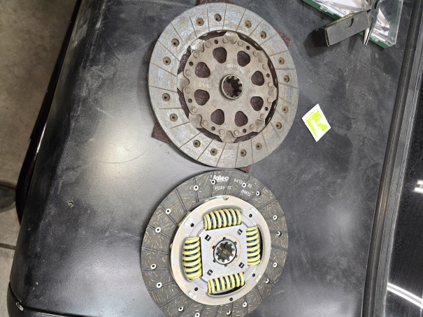

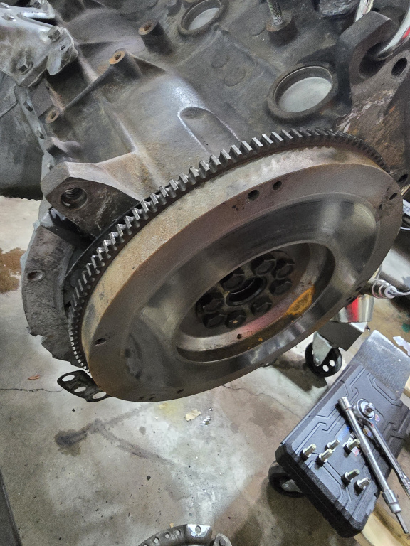

    I had some help and ordered what was supposed to be an m5x clutch kit for my s52 with getrag 260 project.
    Preasureplate did not line up. Friction disck looks like it will work.
    What came off it was a sachs mf228 pressure plate amd disc. Can any give me a proper part number for a plate thatll fit?
    this franken car has been a nightmare. Im keeping a list of cars I need to reference for proper parts

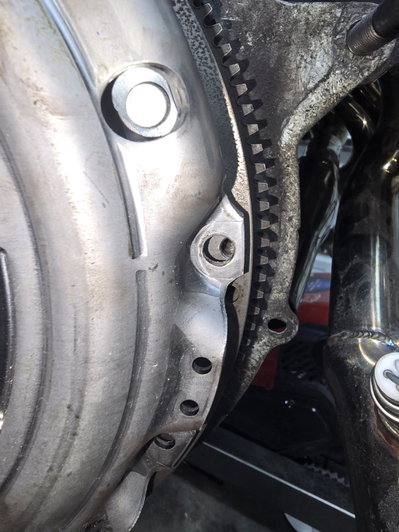

    Bolt holes not lining up

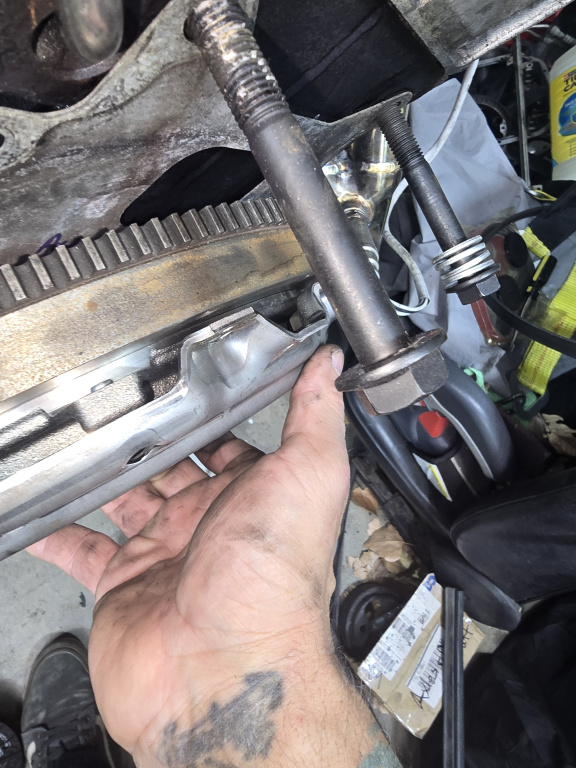

    New plate wont sit flat
    original plate
    Discs
  • TobyB
    • Oct 2011
    • 5286

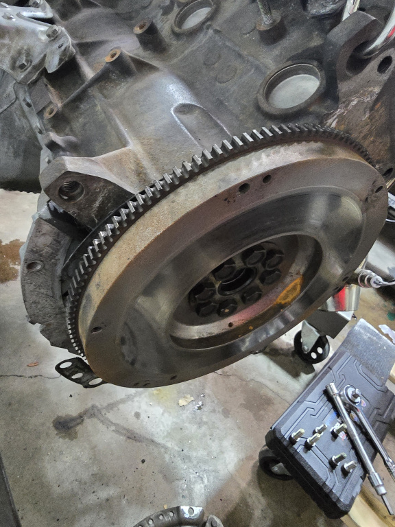

    It's going to depend on your flywheel.
    Your best bet will be to order parts for whatever car the flywheel came out of...
    I see a dual mass friction plate there...
    t
      t
      My flywheel is single mass unless im looking at it wrong. I think they used an m20 flywheel based on my starter part number of 12411466099
