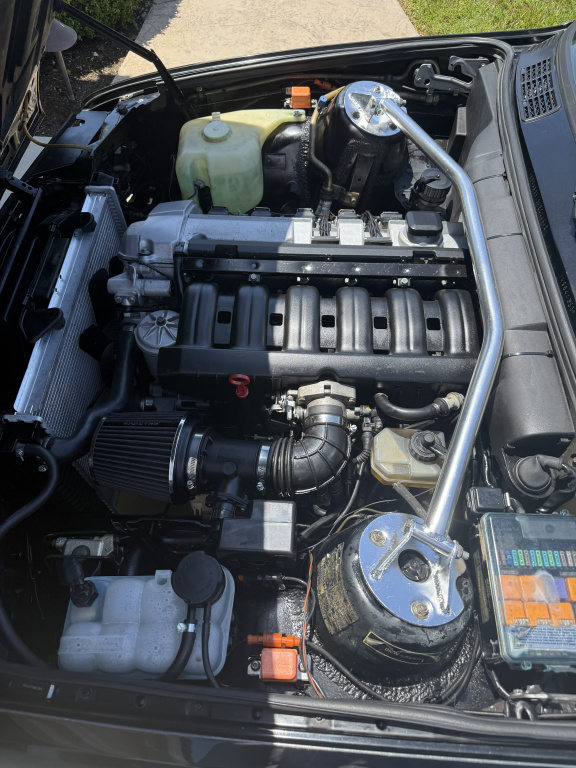

    Hi all
    just had a shop complete an s50 swap on my e30 and to my surprise the guy used “race cats” for the exhaust and now I’m stuck trying to figure out what I need to make this thing BAR legal (I’m in California unfortunately) I’ve looked all over market place and can’t seem to find an original system that I can modify and use. Would a system from a m50/52 work or do I need to find specifically one that is for an s50.
    Car has s50 headers (original) whatever bs “race cats” and a stromung exhaust I had on my car before. The thing sounds like a boat
    any suggestions would be great.
