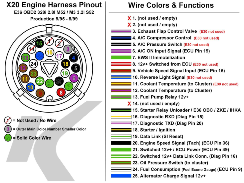

                    MS41 X20 pinout (same across M52/S52 E36) (by Kadunza, can't remember their r3v handle)
                    He never made M20 1988+ pinout diagrams like this, only early ones.
                    My notes for my '88 (325e) say C101 Pin 14 is VSS. Black/White on the engine harness side, Blue/White on the body harness side
                    My old notes for my '90 are terrible and don't even have it listed, but I found some '90 pinouts in old posts that also say pin 14, so '89 is likely the same.

                          VSS - check what you did against the X20 pin 9 to C101 pin 14 stuff above - check the wiring colours to make sure they're not going straight to power or GND first. I'm only like 75% confident about the E30 side of that pinout...

                            now my biggest question. i went to verify VSS because INPA said i have vehicle speed and to my knowledge even with the e30 signal it should show at least something right?
                            i have the vss engine code and no live speed data when driving
                            now i went to check the x20 connector and pin 14 on the engine side is gone. doesn't exist. so obviously theres no speed reading.
                            my question is what pin on the ecu connector is the speed signal. becuase every single person and diagram on the internet says something different.
                            the car is a 1996 e36 328i convertible, was automatic so the harness is automatic.
                            • Steez30
                              • Mar 2025
                              • 14
                              Nevermind i got it figured out. To solve this issue I ran a wire from the green connector on the back of the E30 cluster, that housed a single blue and yellow wire and ran it through the dashboard to the ecu connector. here i splied the wire into pin 15 of the back of the ecu connector. it was a brown wire with a red stripe. its technically called the asc/abs pin, but inpa showed a speed reading once i did this. hopefully this helps someone else doing a 24v swap
