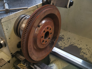

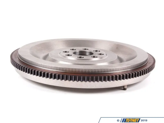

      Here's the step in the back (engine side) of the stock M20 single mass flywheel.

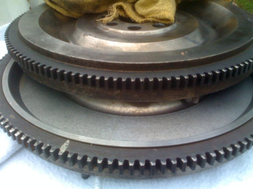

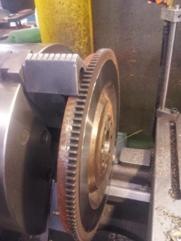

      Here's an example of how it should look after shaving until the lip is 1~2mm from the ring gear face:
      Some people go further and remove more material (bottom, stock on top) but I don't think it's necessary.:

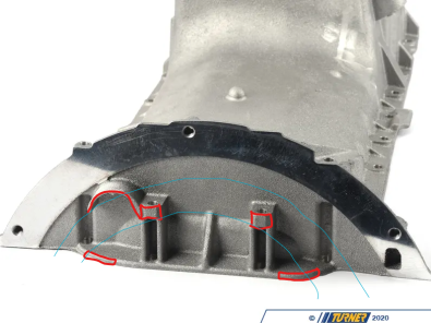

      Shaving the pan, It should be easy to see where once the pan is installed and you can stick the flywheel on. I haven't done this, but it's probably something like:
      Blue is probably where this edge sits, and red is where you might make contact. ​​

        I also don't think shaving the lip down is going to make much difference to drivability. It's easy to look at this and say "that's a lot of material" but I think it works out to ~1kg on an ~8.4kg flywheel, plus the mass of the pressure plate.

          On a few 24v swaps, I've had the back side of the m20 single mass flywheel shaved down by a machine shop. It still weighed about 16 lbs, so it's wasn't crazy light. For street driving it was perfectly fine and made the 24v feel a little peppier. I've had bad luck however with the m20 aftermarket clutches making too much noise upon engagement or being overly grabby (had to go this route before due to s52 swap with m20 flywheel) but your results may differ.

            Alright, thanks for the input. Definitely gonna shave down the m20 flywheel and use the fresh clutch and pressure plate I already have. Unfortunately the original dual mass attached to the engine was fried and had wayyy more than 20mm of play in it, so that went straight to the scrap pile.
