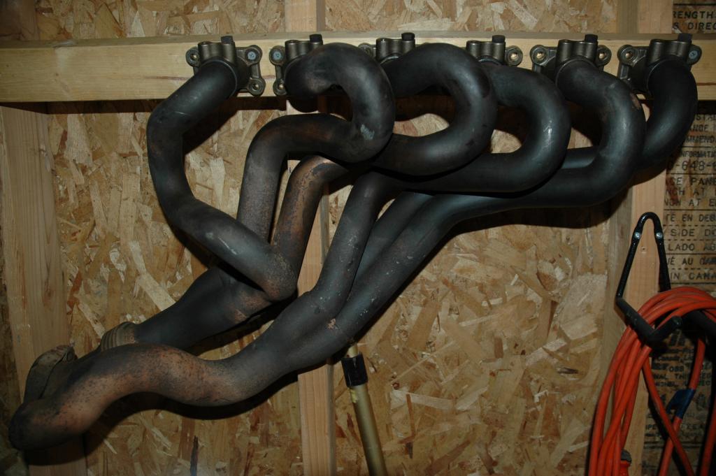

            • erik325i
              • Jan 2005
              • 3567
              #51
              Originally posted by MIKe30
              erik, what did you do with the little holes at the top of each runner where it bolts up the cylinder head? Looks like there are two holes, one is plugged up with a bolt, the other open... shouldn't just leave it open like that right?
              The hole that is not plugged is just for the heatshield that bolts above the headers. I didn't use that heatshield in my m3, so there is nothing in those holes.
              Here is a pic I just took for you of my brother's headers with the heatshield installed.
              Erik

                • hoveringuy
                  • Dec 2005
                  • 2747
                  #53
                  I have a new favorite garage decoration. It's too damn hot around here to contemplate installing it right away....
