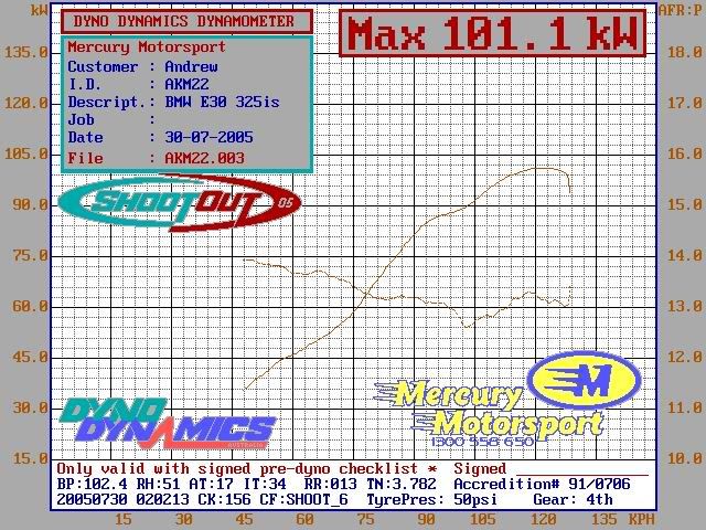

    I got my car to the dyno this week...was good to spend some time dialling in the ignition timing. We came away with 10rwkw over what it had on the "home" tune. Was also interesting to play with the vanos...leaving the cam advanced cost about 10kw...and we're now retarding the cam at 4250rpm.
    Anyway, car is noticeable better for the dyno time.
    This is my old M20B25:
    The final dyno result:

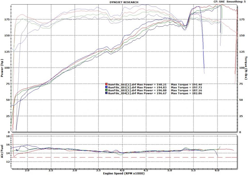

            This is what it looks like when torque dips before the switchover point. Ok, it's an extreme example. Yours doesn't even show the changeover. Nice!
            The smaller dip is DISA switching.

              • EtaSport
                • 2853
                That last dyno graph show pretty much what mine does at ~4k. Mine peaked about the same point as your m52, but my HP curve stays flat all the way to redline and doesnt drop off. 225hp from 5500 to 7k with a 3.1liter. I think the cams make a large difference for the upper range.

                  Interesting to see that dip Steve!...Rick had a drive of the car at the track on the weekend before the dyno session, he mentioned how there was a definite change in torque after 5000rpm or so...so I think we now know why a change could be felt. Now it's just on the go all the way through the rev range.
                  BTW...my vanos switch point in actually 4250rpm...not 4000...switching at 4000 created a dip around 3500.
