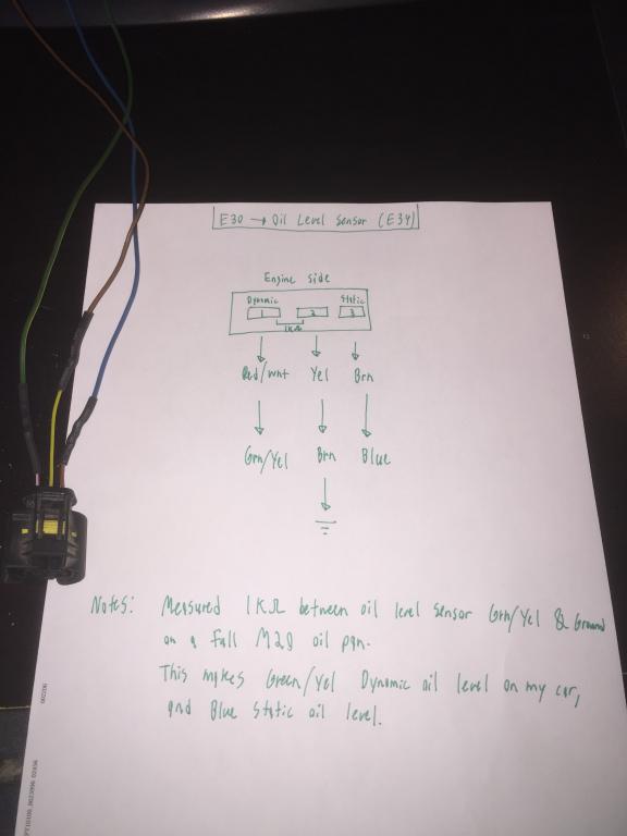

    The solution to wire up the E34 oil level sensor:
    Note that I didn't have the correct connector, so I made due with one that fits the pins.

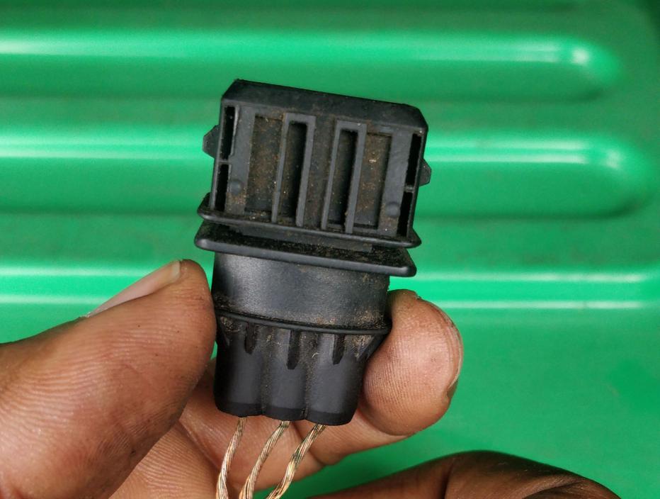

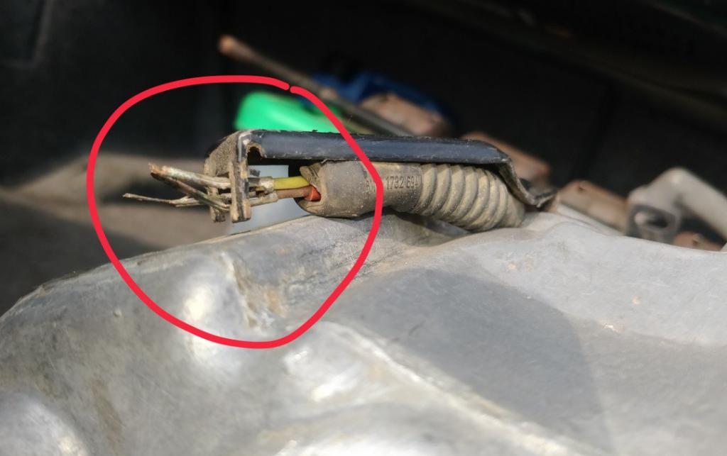

      Originally posted by jake5
      Can anyone tell me what pins are what? I.E which is 1, 2 and 3?
      Does anyone know the name of this type of connector?
      Mine is broken but the wires are still intact. Click image for larger version
        It is an AMP housing style connector which can be purchased from Mouser, DigiKey, etc.
        Here is a link to help you get started...click on the data sheet and study the dimensions to see if one of these is a match...otherwise you will need to search a bit.
        MJ
          https://www.mouser.com/TE-Connectivi...yvsm2eZ1z0yy6b
          MJ
          Thank you. I found its not the same with most crankshaft sensors connectors so I'm going to have to find it and its specs as this one below didn't fit properly.
          Click image for larger version  Name:	IMG-20201127-WA0021.jpg Views:	0 Size:	64.1 KB ID:	9962309
          ​​​​​https://shop.efiexpress.com/products..._connector_kit
          AMP Junior Power Timer 3 pin male connector kit
            It may just be easier to convert both the male and female to a matching connector. I found a few examples.
            This seller has a good selection and seems to move a lot of parts:
            https://www.ebay.co.uk/itm/Genuine-M...EAAOSw~yNZ5NBl
            As an alternative there is always something a little more unknown:
            Hopefully this helps, if you search for "3 way power timer" you can find some more results.
            MJ
