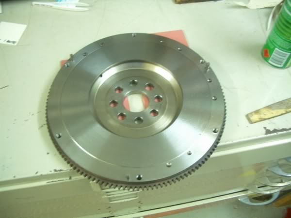

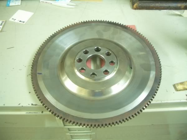

                  I had my flywheel taken down to 15lbs
                  Friction surface:
                  Backside:
