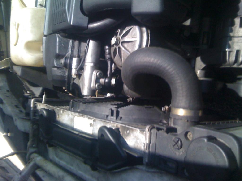

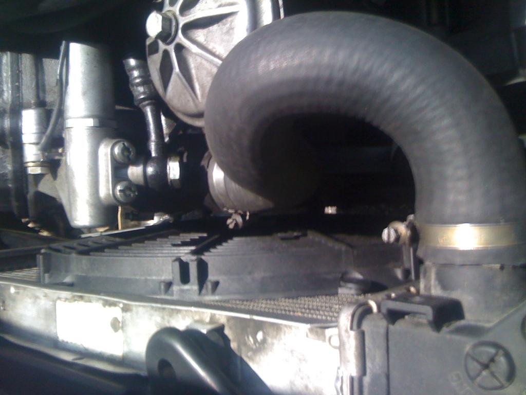

                      pardon the not so clean engine bay, i was bleeding the cooling system and that crap gets everywhere. the wiring is pretty f'in ugly too so that will be addressed over the weekend, i just wanted to get everything hooked up to make sure it works :)
                      pics:

                        Pardon my ignorance on this subject, but you had to delete your fan clutch for this mod to work correct?
                        • dude8383
                          • Jan 2005
                          • 10387
                          Originally posted by EightiesBaby
                          looks purrty
                          well SOME people can fit the clutch fan, in my case there is no room for it!
                          • EightiesBaby
                            • Jul 2008
                            • 268
                            so those people would be running THREE fans?
                            • dude8383
                              • Jan 2005
                              • 10387
                              oh hell no man. you only have two choices for the radiator side, clutch fan or electric fan.
