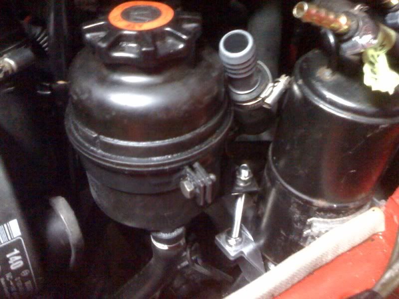

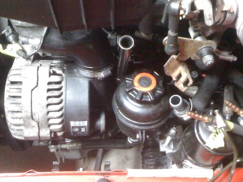

              I made a nice little power steering res. bracket with a 4'' piece of I think M8 threaded rod and some nuts and lock washers off of the driver side mount arm. I had to shorten the line from the res. to the rack, for some reason that line came right out at the mount arm.

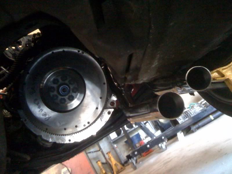

              Here's one of the flywheel after installation... notice the SS reps hit on the trans tunnel... and still do after the transmission is in. Did I get a shitty set? Oh well.. I will have to heat them and bend out of the way.

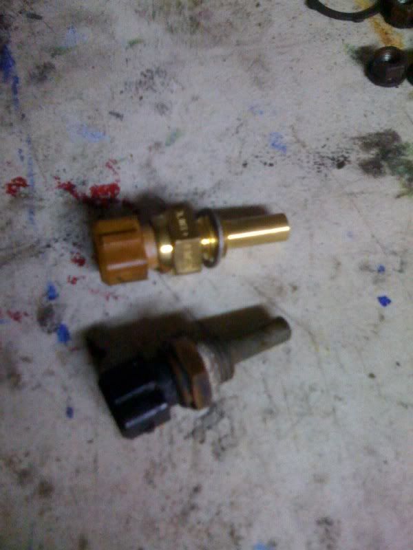

              Here is the temp sensor on the head that must be changed for correct temp reading on the gauge cluster. I looked on real oem and the m42 and m20 part numbers are the same, so feel free to use either. It's the one in the middle.

              And the dreaded NYLON barbed fitting I used... I boiled one of those guys for about 20 minutes and then tried breaking it with a pliers, needless to say it held up and didn't melt or break. I think it is ok to use.

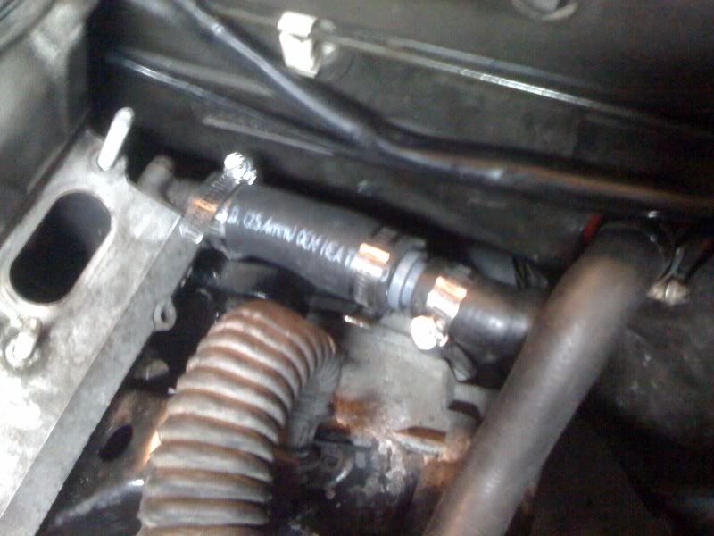

              yeah... spider hose to the top, hose from back of head to the bottom tube.

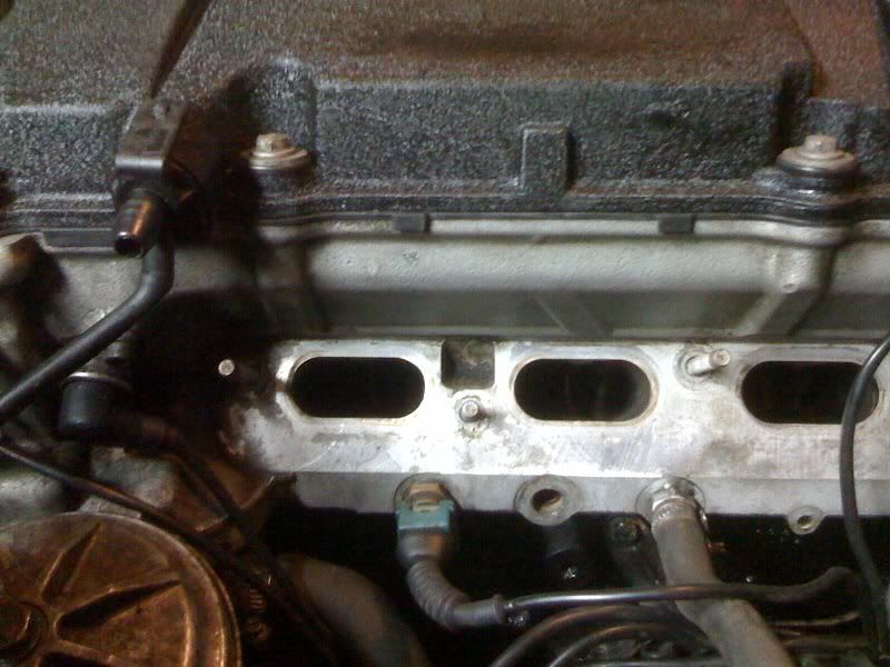

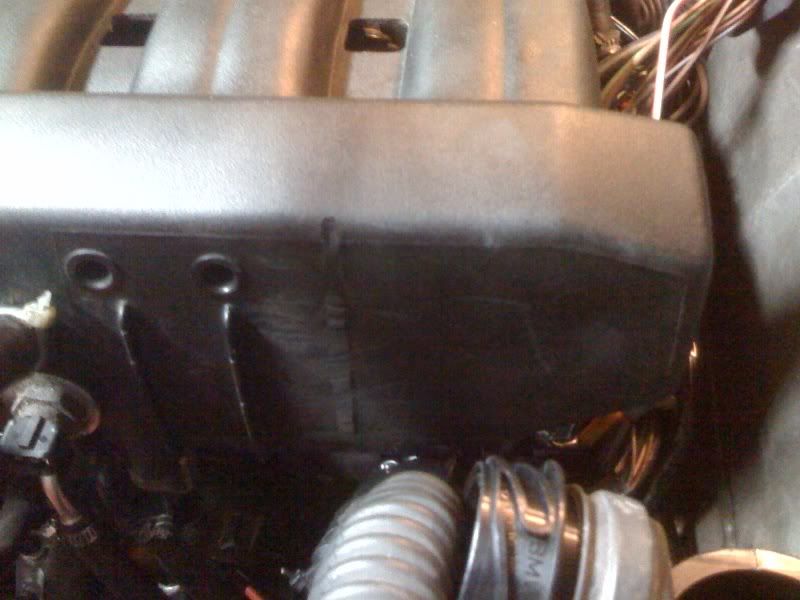

              Picking up a 944 booster tomorrow. Hope it goes well and clears the intake well. For some reason other people's intake mani's seem to have way more fins than mine, maybe its a NV thing. Notice the fins don't even start until 4-5 inches down, so I shaved one of them in case it gets in the way.

                      Ahh.... I had a valve on the charcoal cannister (m42 setup) is that the purge valve? I should also note that the gas in the car is exactly 1 year old, although I did add the fuel additive for storing fuel when I got the car but I'm sure it is shit gas. The car also vibrates like hell probably from that SS rep tube being right against the trans tunnel.
