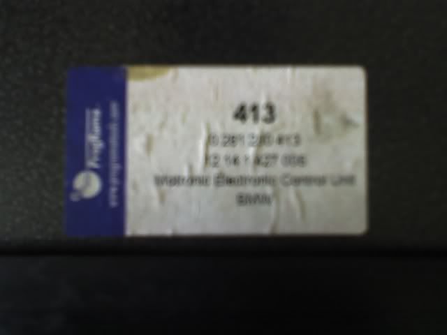

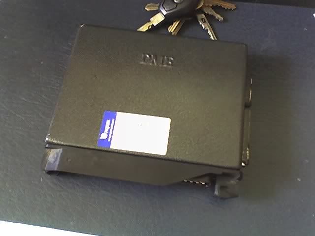

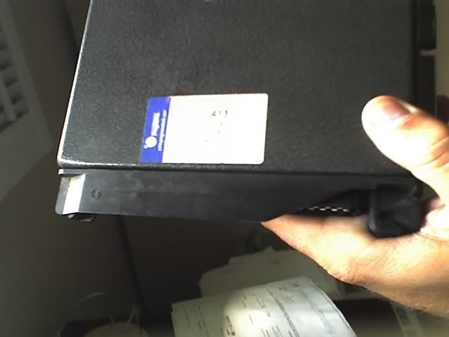

            I'm working on getting a picture up. The label isn't all blue in the same way that a "red label" is all red. The label is mostly white with a blue edge. The edge says www.programatools.com.
            hmm, maybe this thing has been rebuilt or something. the casing has a gray texture painted on it as well.
            I wish I would have looked at this thing before today.

              does the label look like this one except blue?

                camera phone, but you can see the painted case and strange label.

                  I'm thinking its been serviced or rebuilt or something. I don't know how to tell if it was a red or silver label to begin with. I guess I'll just have to go on the seller's word.
                  No damage will be done if its a silver label, right? It just wont start?

                    That's a rebuilt unit. Plug it in and see if it starts.
