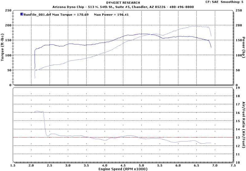

    Originally posted by mazur
    Dont you have a better chart BTW? You know, with RPMs...not MPH.

      wow, is that afr correct?

        Riiiiiich! Very nice numbers though. I'm hoping for a (realistic) 170whp with a chipped NV.

          Haha, yeah it really gets rich at the end there. Good luck dude, I bet that's pretty attainable with a NV.

            What's with the weird dip at 5500? Isn't the VANOS timing switchover point at 5k?

              Maybe it's VANOS switching off?

                That's what I meant, it's supposed to happen just off idle, then again around 5k. But I've never seen a dip like that. Maybe that's what the M3 cams do on a 2.5 motor?

                  That's not that rich.
                  Not much of a dip as vanos turns off either. That's a function of cam timing. This is really a nice graph.

                    lol i wish my afrs looked that good....

                      Nope.
                      Nope.
                      Yup.
