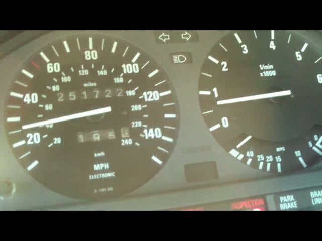

          #34
          It's a little difficult to see the difference in the video. ~20whp isn't THAT much, just a noticeable difference to the driver. I didn't launch it, just rolled into the throttle in first gear. I ran a 14.4 @ 95 without the cams, it feels like I should be able to do 13.9-14.0 @ 98-99 or so with the cams.
          WITHOUT s50 cams
          I took this video a few hundred miles after doing the swap. It's an m50b25tu from a 94 525i. Dinan chip, 2.5" exhaust, cold air intake. Getrag 260 and…
          WITH s50 cams and cam software:
          This is an m50b25tu with s50 cams and the correct software for the cams. I also have a cold air intake and full 2.5" exhaust with SS long tube headers, Borla…
          The bottom end still feels a little weak, I'm not sure if it's just the increase in power up top that makes it feel that way, or what. I know the seal kit takes 200 miles or so to break in, so I'll give it some time.

              #36
              Good stuff, I have s50 cams waitin to be put in once I gather up all my other parts.
              • Jean

                                First video looks like 0-100 is about 14 sec +/- a second seems you launch around 5 sec mark and hit 100 around the 19 sec mark. 0-60 around 6 sec..
                                Second video looks like 0-100 is about 11.5 sec. Launch 4.5 sec reaching 100 by 16 sec mark. 0-60 around 4.5 sec!
                                I think those gains are worth it!! You can see the power gain for sure!!
