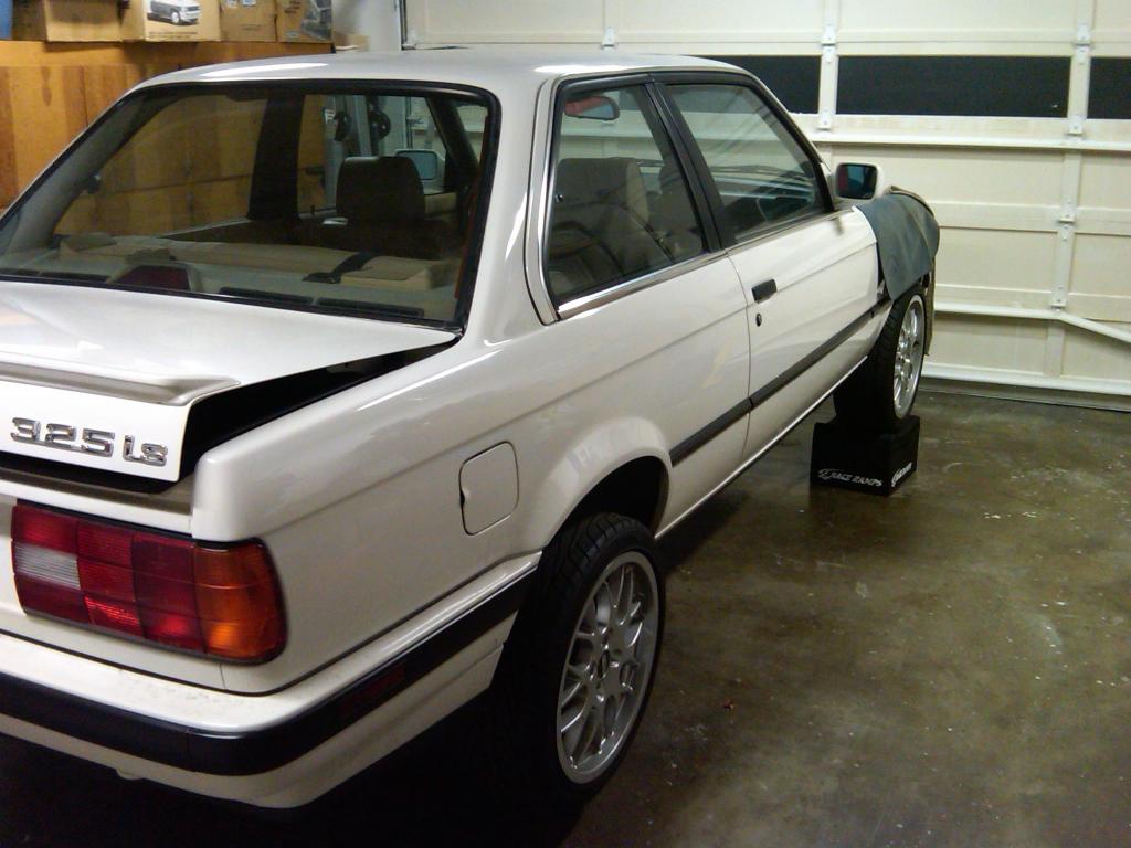

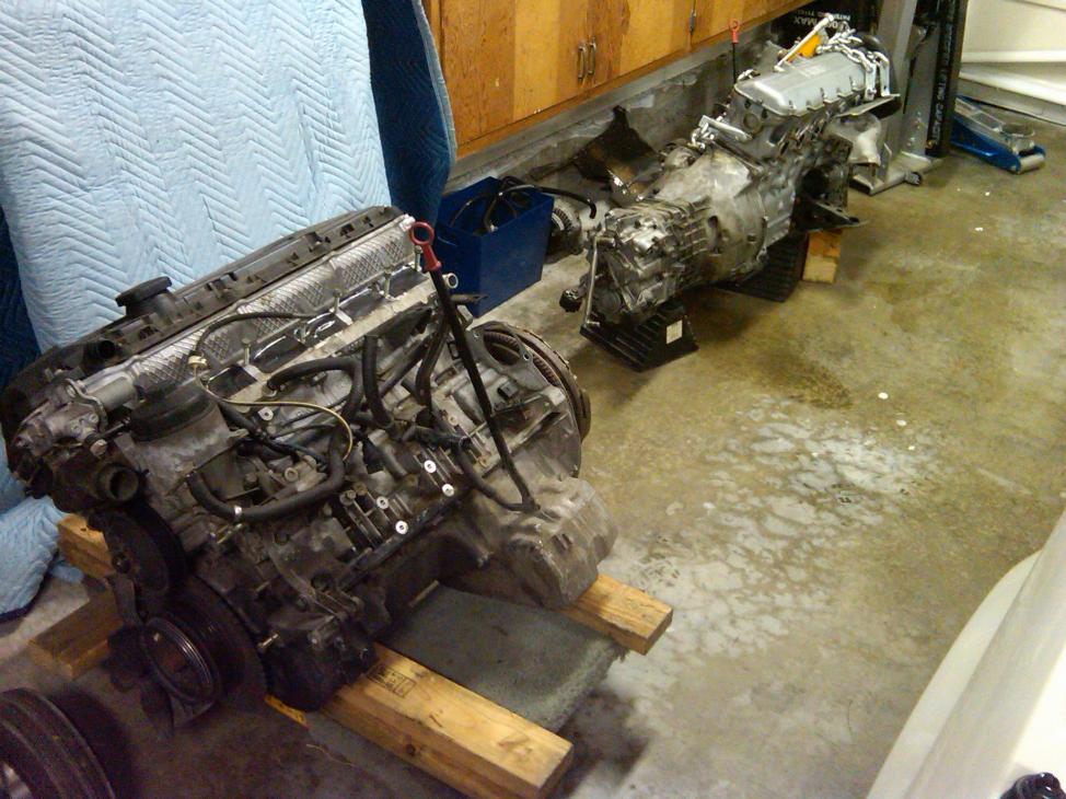

    Well, after years of lurking on numerous e30 boards, I am finally starting out on my project. I thought those of you here whom have gone through this process may appreciate the start on a motor swap.
    Here's the details:
    1997 Z3 M52 <90k (torn rear body mount for differential)
    5-spd
    1989 e30"is"
    Been mostly stock during it's life with me over the past 10 years.
    Dinan DME chip
    Eibach springs
    Bilstein HD's all 4 corners
    HID retrofit
    Z3 shifter
    I love my e30, dunno why some days, but I just love it! I've had both the Z3 and the e30 out of commission for roughly 6 months or better. I'm not gettting any younger and I want my garage back! So here I go, diving in head first.
    I want to say thanks to all of you who have posted informative information over the years here @ R3V. It has been an invaluable source of information (albeit, sometimes more entertaining at times!).
    I'll post pics as the swap progresses along if there is interest. Any useful tips and help are always appreciated.

    Nice, an alloy block. I'm toying with the idea of yanking the M50 out and sticking in a cammed alloy M52 in a year or so.
    You're actually removing weight from the front axle, congrats. :up: Keep us updated! This isn't your only car I assume...

      I like those race ramps :)

          Lucky bastard, where did you find a single vanos alloy block?! :hitler:
          Good luck with your swap! Atleast your car wont suffer in handling from all the added weight that the cast blocks add.
          Should be fun! Get some s52 cams, injectors, and a tune while you have the engine out! Well worth the money! :D
            Just about...
            N52 255lbs
            M20 258lbs
            M52 (alloy) 260lbs
            M54 277 lbs
            M50 299 lbs
            Oh yeah,
            M10 180lbs!

              Well, I gotta say, the whole car came from an old customer of mine. It was his daughter's vehicle and they didn't know what to do with it! So, I took the opportunity......
              Race Ramps - For those of you whom are familiar with this product, it is by far the best ramp to have out there. I have both the 2 piece ramps for the front and the 8" wheel cribs for the rear. Great customer service and will plug for them any chance I can.
              I am on the hunt for S52 cams/springs currently. Also S52 injectors.
              As far as a tune goes, lots to ponder. Turner Motorsports? I know there is one other guy out there, I believe in Canada, who does not only a chip but the EWS delete option as well. I will have to search though my bookmarks and find him again unless someone has it readily available off hand.
              I plan to set in the motor/trans to take some measurements then do a small bit of internal rework to the engine. During this time I plan to lay out the stock m52 harness and figure out routing and component placement.
              Speaking of components, anyone here have a source for C101? Spares laying about in the garage you don't need anymore? LMK....

                      Originally posted by hoveringuy
                      Just about...
                      N52 255lbs
                      M20 258lbs
                      M52 (alloy) 260lbs
                      M54 277 lbs
                      M50 299 lbs
                      Oh yeah,
                      M10 180lbs!
                      One of the guys who actually weighed both engines (Drew325is IIRC) removed ~50lbs from the front of his car going from M20 to M52. The weights were comparable.
