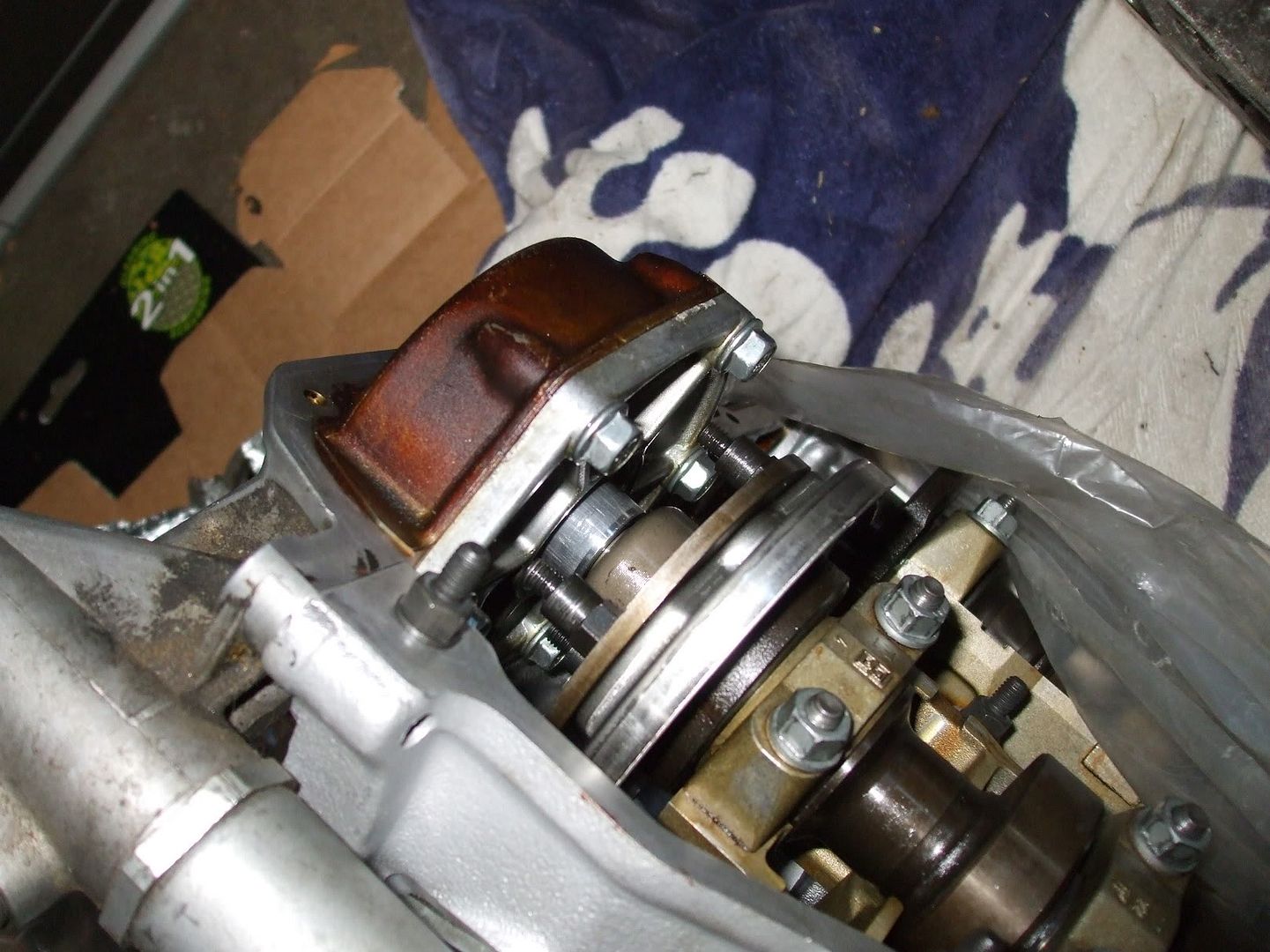

            M50NV is decidedly OLDER. NV = Non-Vanos. That's the head I have on my frankenmotor. Oddly enough, VANOS bolted right up.

                      Wait wait wait: how did the VANOS bolt right up on a NV motor? Please tell me more, this has suddently become relevant upon purchase of a 525iX touring...

                        If your head isn't machined to clear the VANOS unit, you have to have that done. Otherwise it's a direct bolt on.

                          Oh and obviously the cams are totally different.
