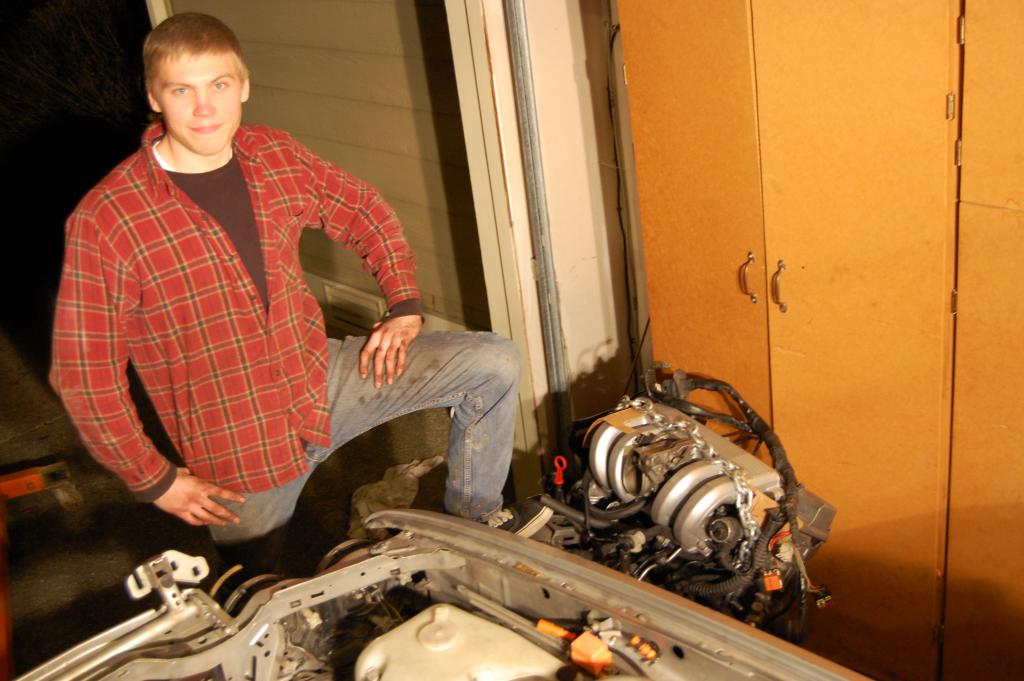

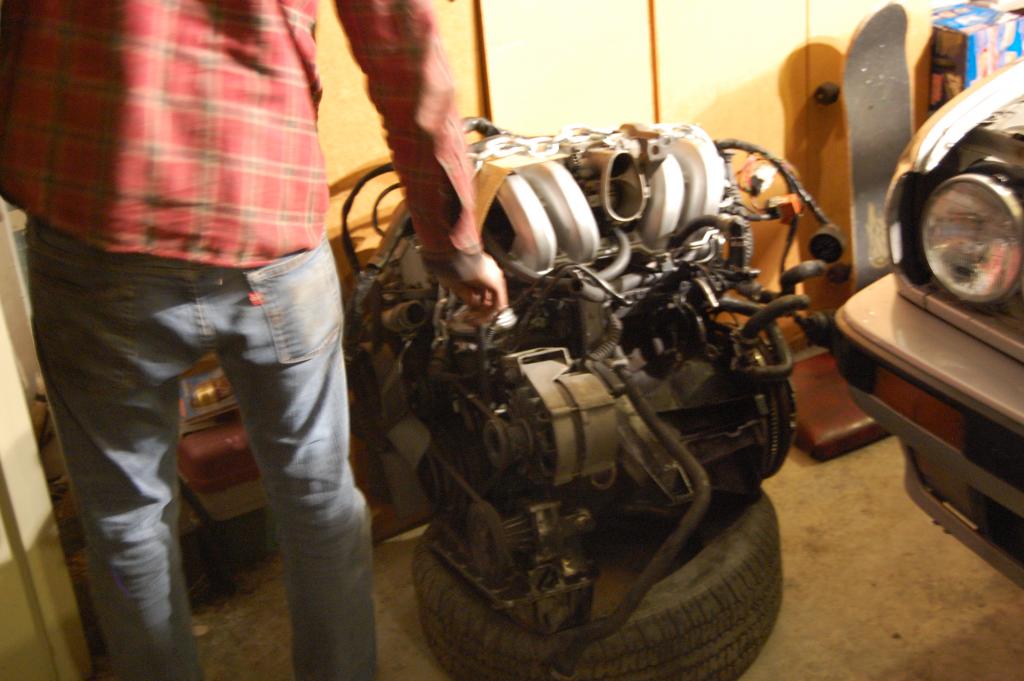

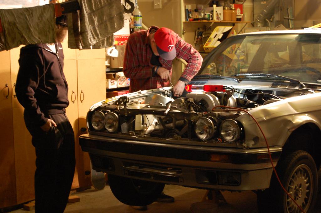

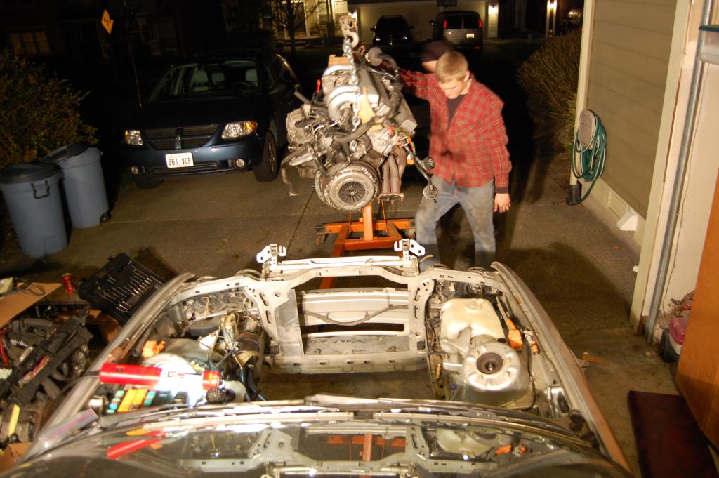

        Update time!!

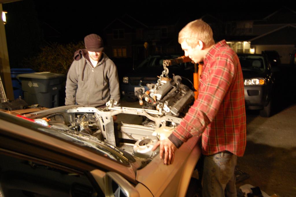

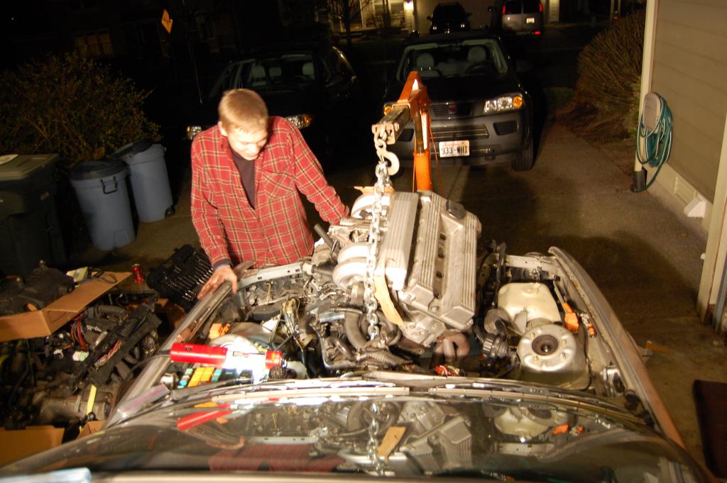

        So Ryan and I got the engine out tonight!!! We drained the oil, disconnected the rest of the lines, put the chains on the block and up it went!! There isn't really much to say while pulling the engine out, so I will let the pictures do the talkin for me. I was wearin my twins hat, but took it off cuz I didn't want it to get dirty.Click image for larger version

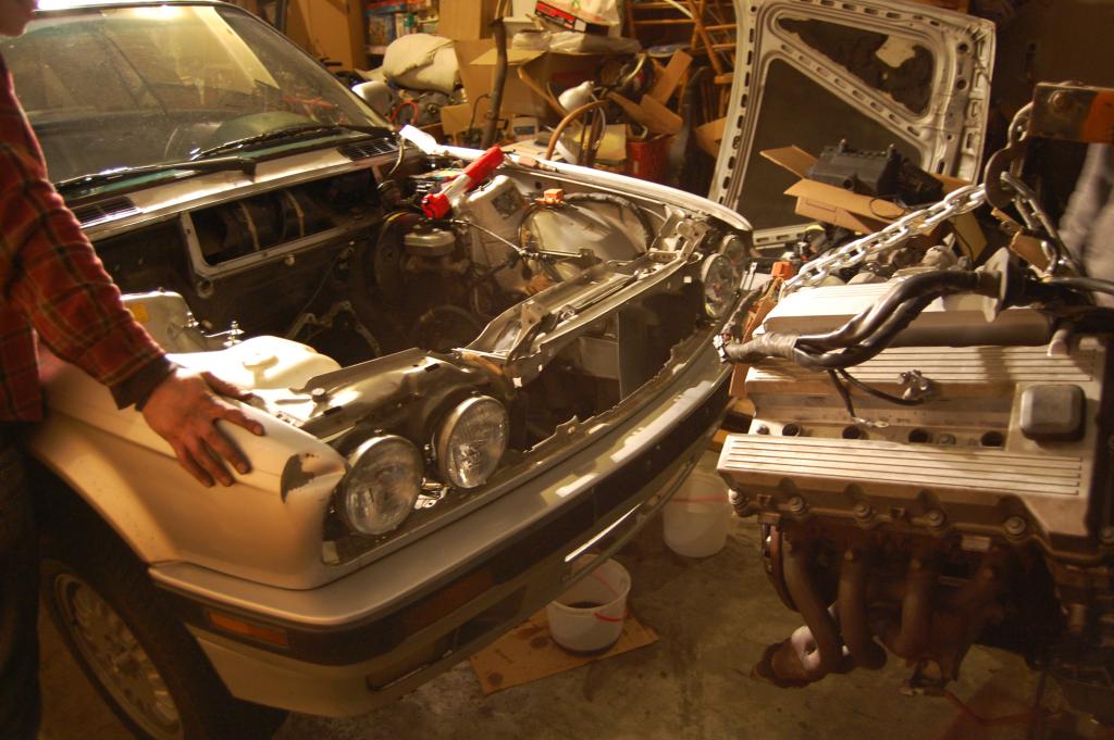

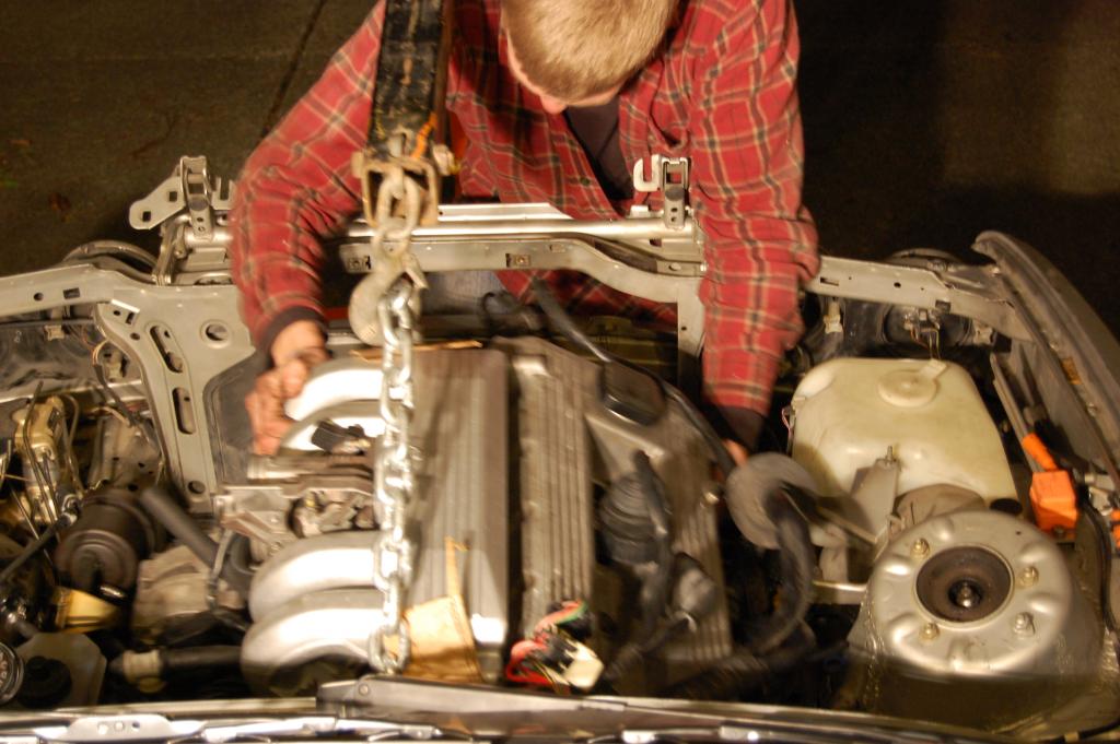

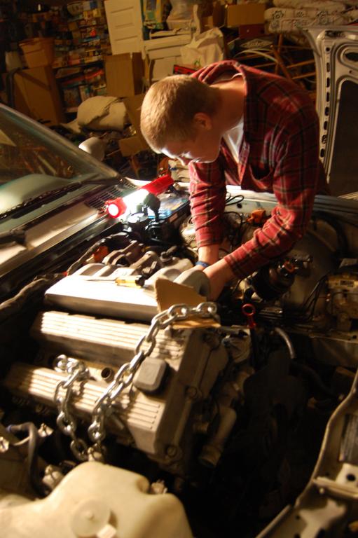

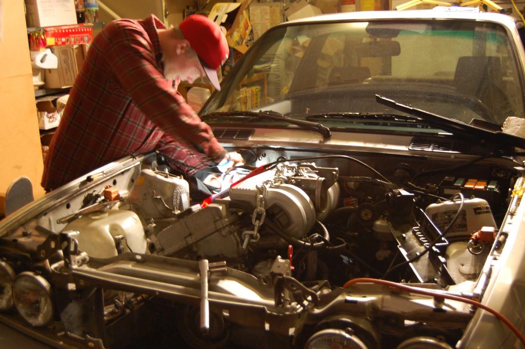

          And more pics...
          SUCCESS!!!
