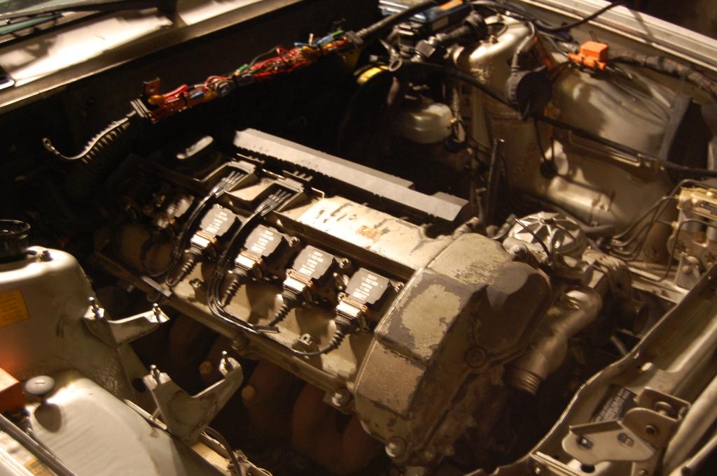

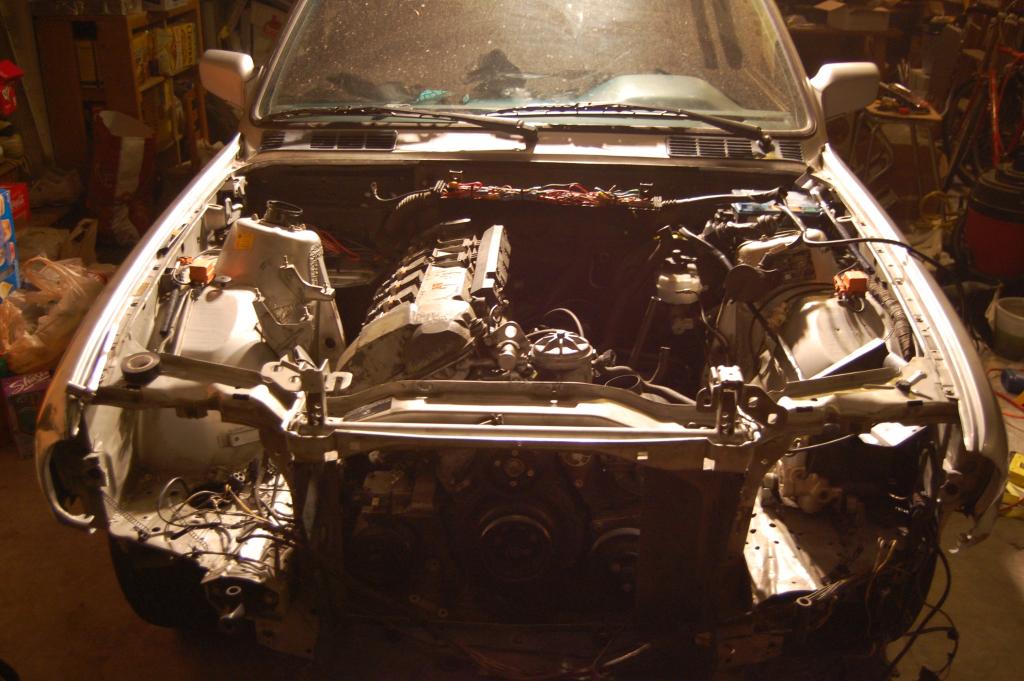

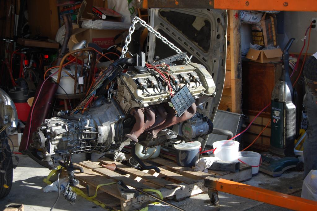

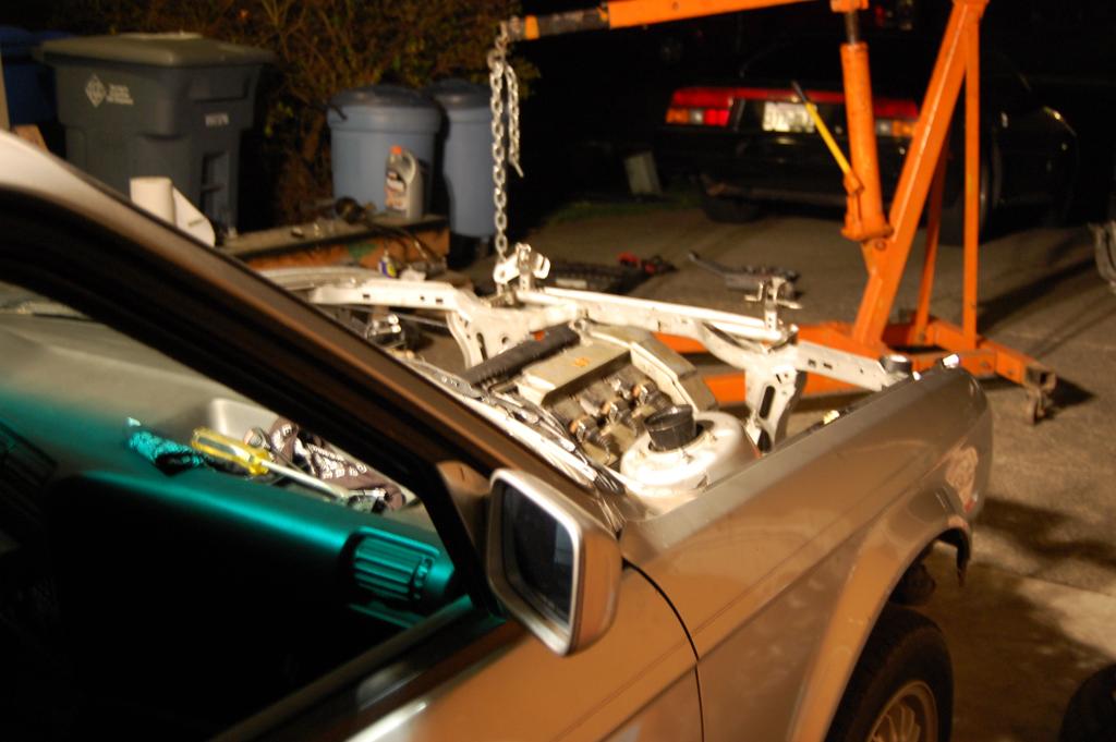

                So today my buddy Stevo and I got an early start to the day. We went to the junk yard and that was completely unsuccessful in finding the brake booster and master cylinder. I had a booster, it was just the wrong one. Awesome for me. We then went and got my intake manifold. Then we went to pep boys or something and got all of my fluids and got some taco's and the taco bus. Best place ever. By far one of the most authentic Mexican food...in Washington. I'm sure there are more authentic places somewhere south? Anyway...We got back to my house and went straight to work on getting the tranny onto the engine. We then spent the next 2 ish or more hours figuring out how to put the engine and tranny into the car. And then...success!!!! I now have a m50 in my e30. I am more then stoked. But...and there is always a but...I hate the mess underneath the intake manifold. I am thoroughly confused on how it all goes back together because I didn't take it apart. If I take it apart, I can put it back together. So I will post more pictures of the mess and all the help from you guys would be GREATLY appreciated. So...on to the pics of the day. Funny pic of me drinkin sunny d. Love that stuff.
