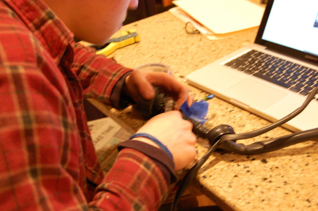

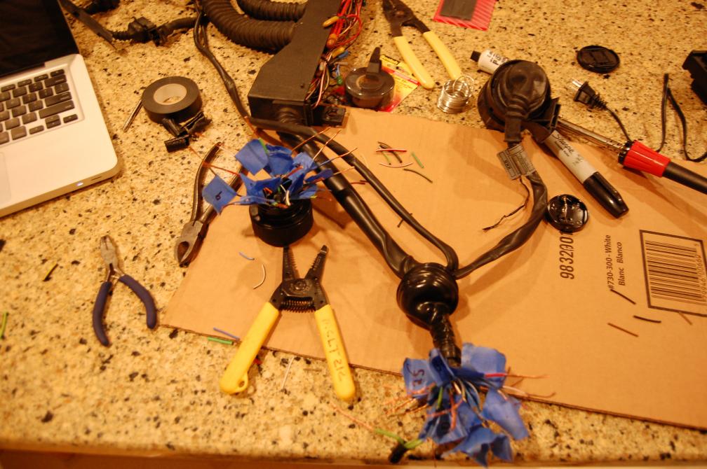

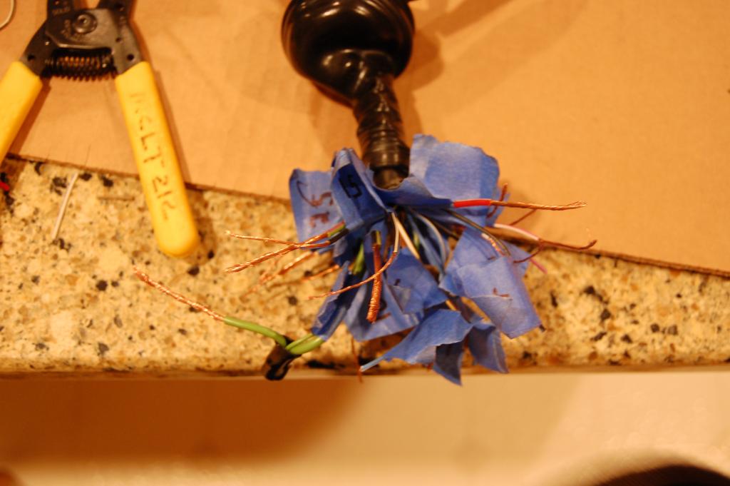

                    Wiring!!

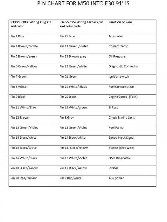

                    A little update. Tonight I tackled the wiring. I found a great diagram with pin and color matching. Worked like a charm. Took some picks of the process. And I am gonna be using the blower motor. I don't remember why I took the cover off. haha. On to the pics. Not very exciting pictures, but I know pictures are more entertaining then no pictures. haha

                      There is some really nice cable management out there that could look a little better than the E-tape.
                      Flexible sheathing
                      Big Heatshrink.

                        I know. I'll clean it up.

                          Where did you find the diagram?
                              I will post it. I just stumbled across it and freaked out because it was the perfect one for me. Here it is.
