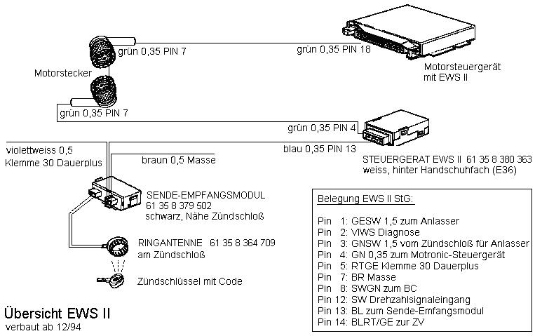

    checked for a signal coming from the output of the box to the ECU and there is a signal there (registers on the voltmeter). If the EWS forward of that didnt work (ie incorrect chip/EWS box etc, which is next to impossible) would i get a signal going to the ECU?

                  are the pins on the ECUs the same no matter what the manufacturer is? what im getting at is, is the pin indicated on here the same on both Bosche and Siemens? (pin 18)
                  there is continuity between the EWS control unit and pin 18 on the ECU plug

                      What version of the EWS do you have? I assume you have it all wired appropriately according to the ETM for the proper version?

                          i have EWS2 so is all wired up according to the diagrams i have.
