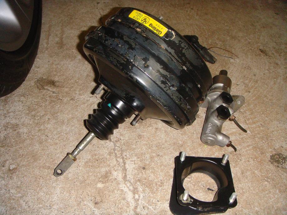

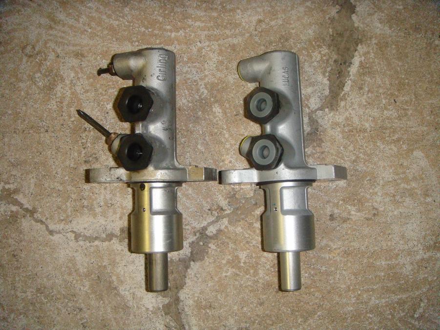

          Okay, My Booster and MC came in today. After reviewing the MC, they kind of look the same. The one on the left is off the 325ix and the right is for 735i. Is there something I don't see? I measured the shaft, the thickness of the shaft, holes and the all line up.
          Thanks,

              They are harder to find than you would think. I looked at 7-8 e32's before i found one with a vacuum booster on it. Most of them have the hydraulic booster that runs off of the power steering pump. But they did only come on the e32's with the m30's as a direct swap. The v8 cars had a booster mounted in the front of the drivers fender directly behind the headlight.
              Yep, 4 bolts(bring a long extension), a clip, and cut the old brake lines off and it comes right off the car. You will need to separate the MC from the booster in order to get it out of the engine bay if the intake is still on the m30. If you can find a V8 e32/e34, grab the 'plugs' that allow for installation of a remote brake reservoir.
              Between the vacuum line on the m30 car and the stock m20/50 you will be able to piece together a working vac line as the distance will be shorter, depending on what motor you started with.
              Mods needed to make it fit include a remote brake reservoir and you will need to bend your stock brake lines to get them to fit as the ports are in slightly different places. Like wheelhop said, you will need to swap the forks. And yes, take the MC that comes with the booster, it is the 25mm version.
              PN for Reservoir : 34321112399
              PN for 3ft of brake hose: 21521163714 (you need 4 feet if you want to run a new hose for the clutch master. 3ft will work if you splice into your original clutch line.)
              As a side note, if you are doing a 24v swap, you will still have to use a bit of spacer on the drivers side engine mount and grind a few fins off of the 24v intake manifold to get clearance for this booster.
