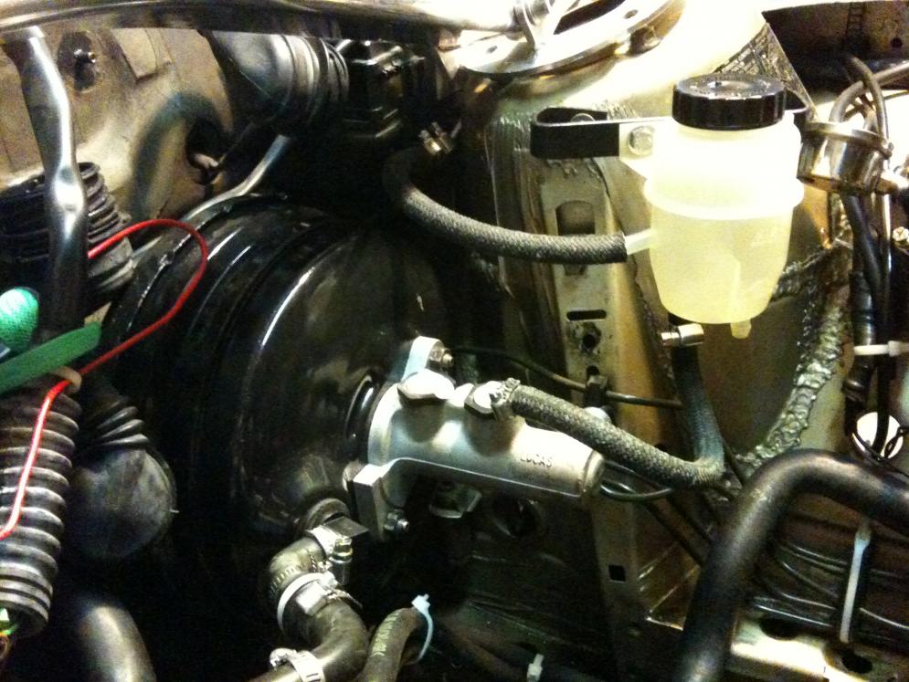

    Surebimmer, I did get a chance to read your thread (great job). Just need to find out from the reservoir to the MC, which fittings did you use. Thanks,
    Fittings to the master to the fluid reservoir? I used the two nipples off a DSM from a junk yard and reservoir from the DSM as well.
    Diamond Star Motors; 1990-1999 Mitsubishi Eclipses, Eagle Talons, and Plymouth Lasers. Took the nipples master and ran to the DSM reservoir.
    As you can see in this picture.
    You are running the bracket on the back of the booster correct?

      No took it off, mounted straight to the firewall. Had to cut 1" off the shaft and mig weld it back on. So far everything is bolting up perfect. Just need to figure out the attaching the hose to the MC. Thanks for the info on the DSM

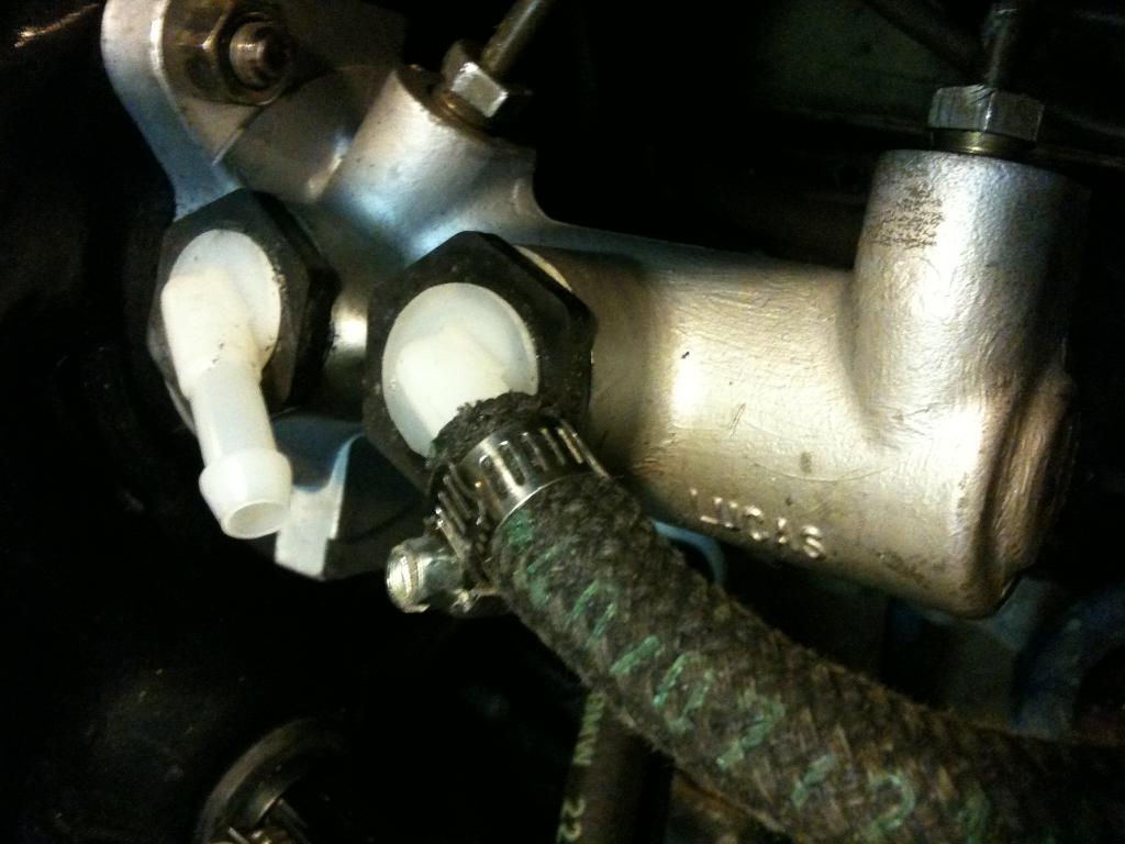

          Cat's out of the bag... found the perfect fittings

            #35
            here's another shot
