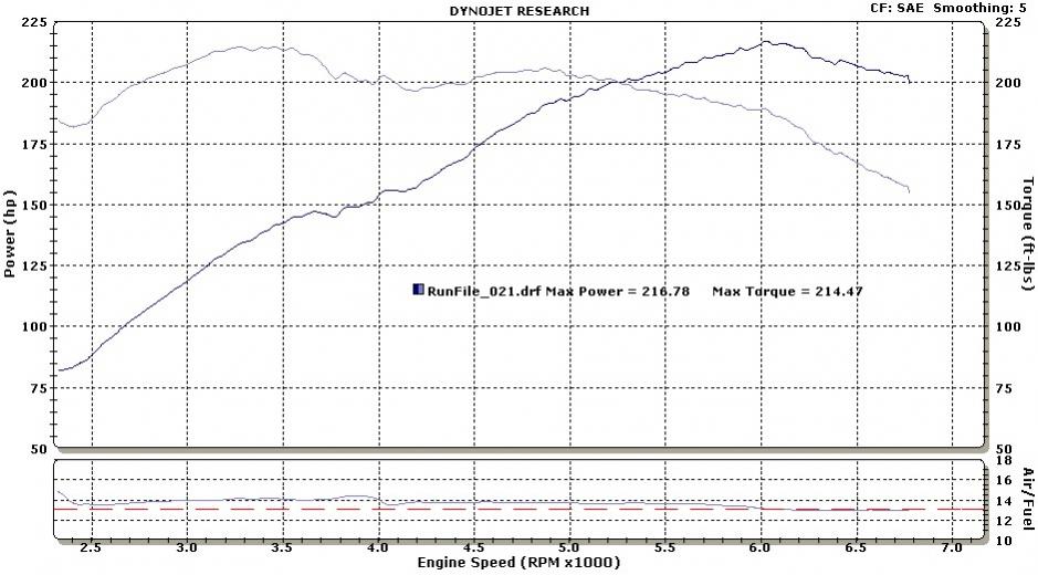

    In an effort to see how the M54 and S50 compare (they each have their strong and weak points), I'm soliciting your Dynojet S50 runfiles so that I can plot the two together. They are both 3.0 litres.
    Let me know what the mods are and I'll post them up on the same graph. E-mail the .drf to hoveringuy@yahoo.com I'll start with mine:
    M54 OBD1, euro headers, OBD2 cats and muffler, TRM tune.

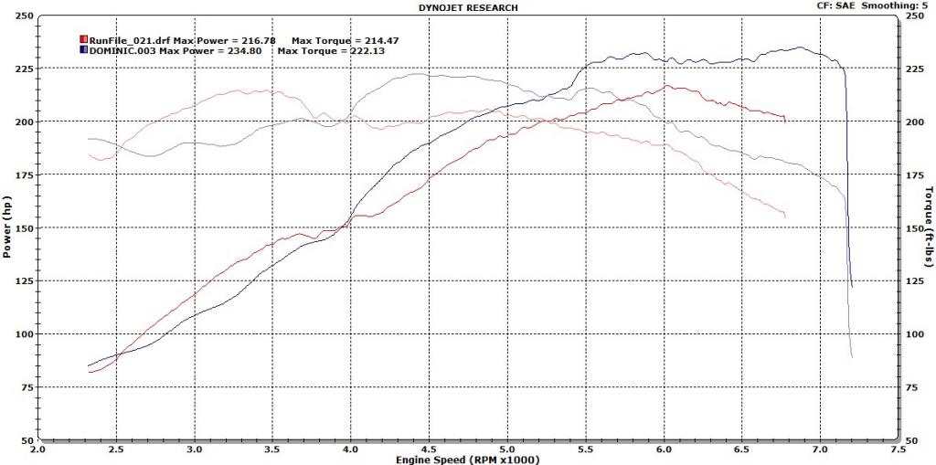

                        Here they are:
                        Dominics S50 vs M54.
                        M54: 1990 325is M54
                        3" MAF
                        24lb injectors
                        euro headers
                        stock OBD2 cat and muffler
                        X5 power steering pump
                        TRM custom tune
                        DISA and dual VANOS
                        S50: 1989 Bmw 325is s50
                        3.5 inch maf
                        24lb injectors
                        ebay headers
                        custom dual 2.25 exhaust
                        No Power Steering
                        Underdrive Alternator Pulley
                        Light Weight Flywheel
                        TRM Custom Tune

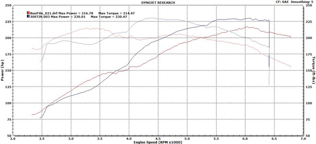

                        Justin's S52:
                        1989 BMW 325i
                        s52
                        ebay headers
                        2.5 single exhaust
                        OBD1 Manifold
                        OBD1 ecu
                        TRM Chip

                          Looks about right. Doppelvanos really stomps all over the older engine at lower RPMs.
                          Also, it looks like the S50/52 both want cams pretty badly.

                            I thought that the extra .2l the s52 has would give it some more hp. as well as a bit of torque. I guess not.
                            '89 Alpine S52 with goodies
                            • JGood
                              • Jan 2004
                              • 7959
                              It does. Different dyno's, different conditions, etc...
