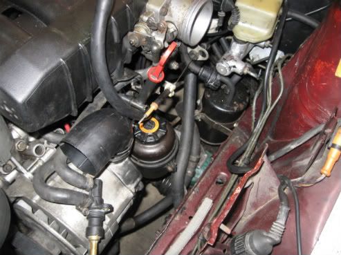

                    Here's my setup if anyone wants to use it for reference. Pretty sure this is what most people do...

                      So, one line on the charcoal canister goes to the throttle body with the EVAP electric purge valve inline, but where does the other hose off the charcoal canister go?

                        Gas tank. It attaches to the hardlines by the firewall.

                          Ok so right now I think I have the incoming fuel line going to the front of the fuel rail and then the return fuel line is coming off the back of the fuel rail and going back down to the gas tank. We blocked off the connection on the TB until I get the electric purge valve/charcoal canister hooked up. The charcoal canister currently is not connected at all. Seems like there were two fuel nipples on charcoal canister, how does all of the fuel system lines route with the charcoal canister hooked up then?

                            Fuel lines are right, FPR is on the rear. Its the opposite of how the M20 is configured. Shorten the rubber portions of the fuel lines considerably, leaving plenty of room for the canister. Keep it up high and test to see if your steering knuckle hits it.
                            There are 2 inlets on the canister, smaller one for the evap/purge with a sensor plug-in going to the TB, the larger going to the fuel tank.
