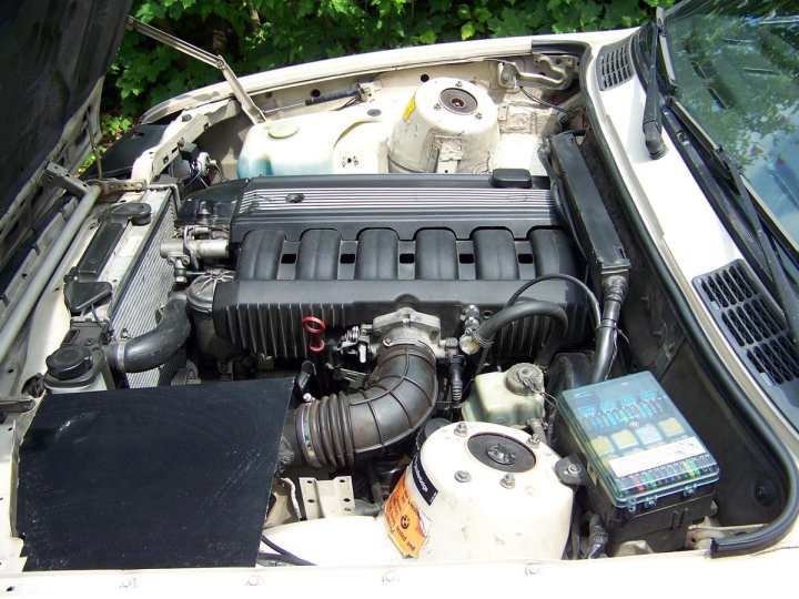

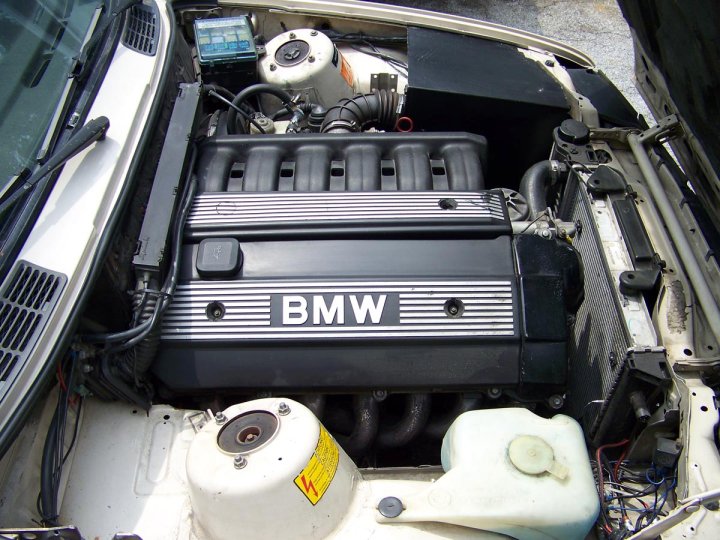

                        Here's mine..

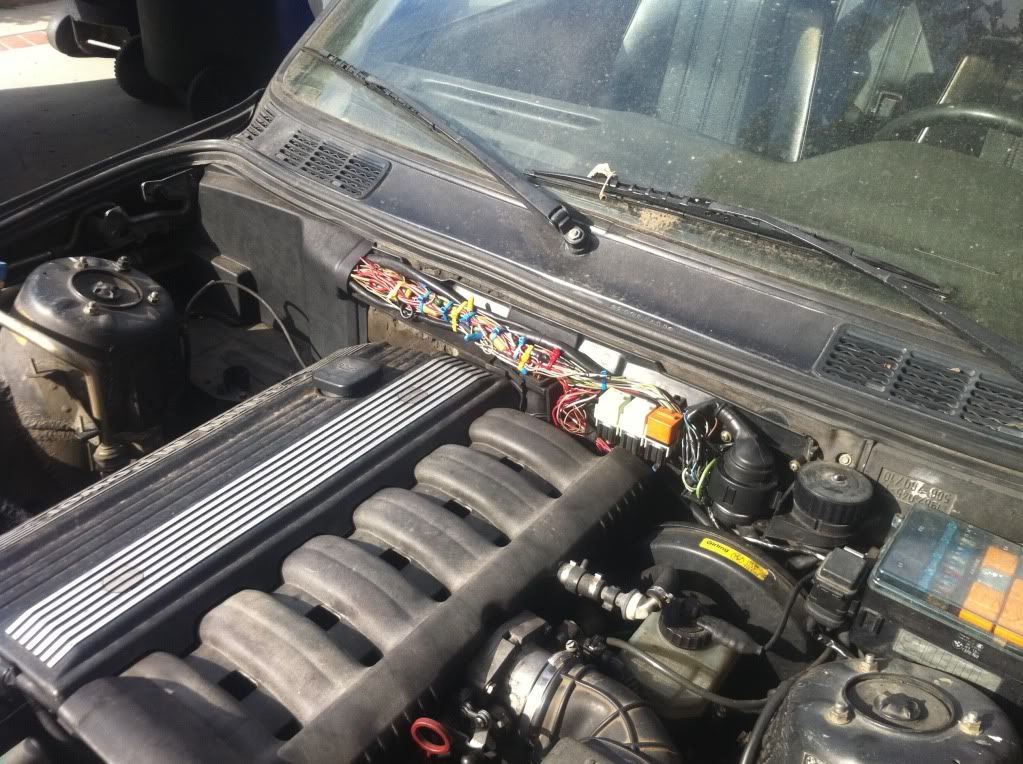

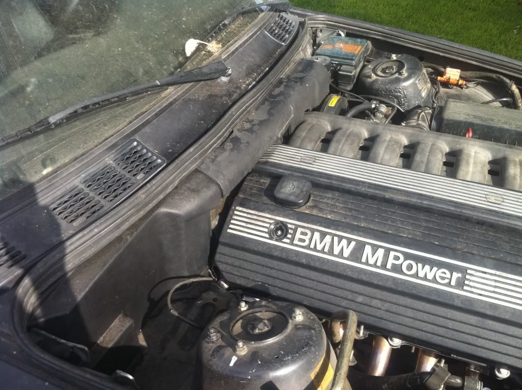

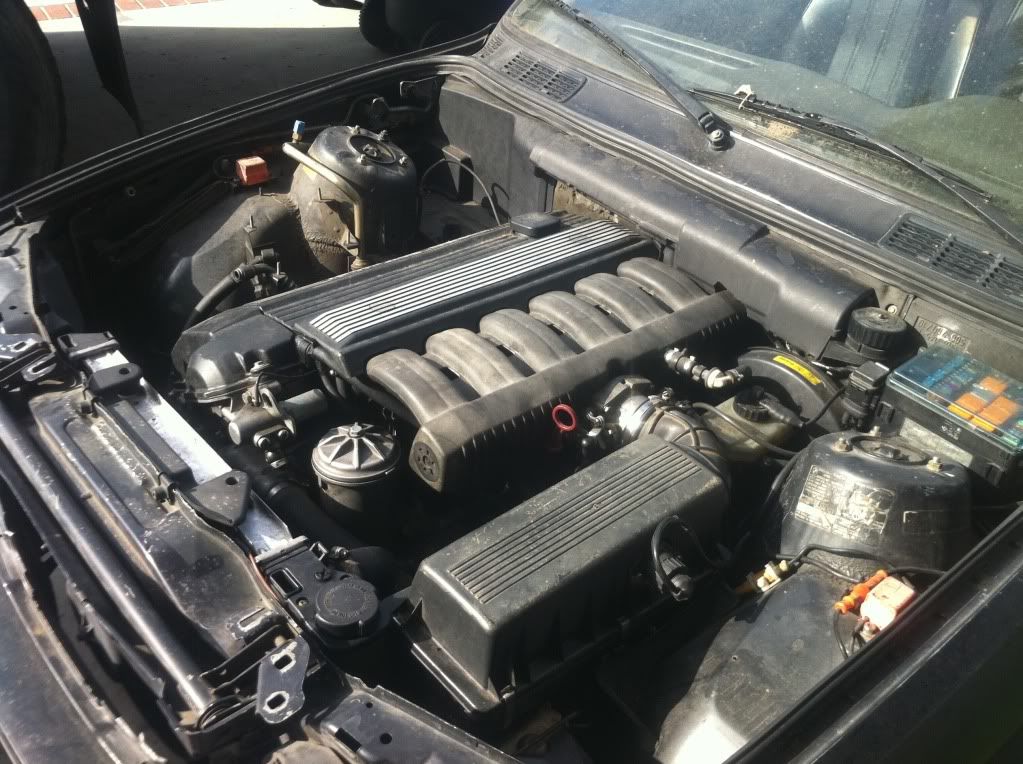

                          Yep, and here is mine. I simplified what I didn't need, shortened the relay wires a little bit, etc. Couldn't ask for a better fit, and nothing is stretched at all.
