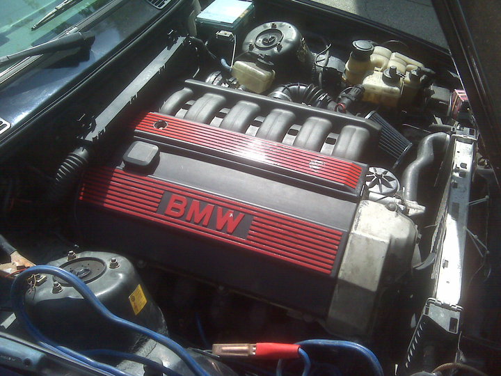

                          I have the support on the drivers side, seems someone deleted it on pass. side, but I was able to set it up pretty good. Now I just have to work out the hoses.
                          Gato: isn't it a bad idea to have the upper hose bent/squished like that at the flange?

                            it looks that way, but its perfectly fine. 4 months with this engine running 100% fine. no cooling issues.
                            either way, things expand when they get hot ;)

                              I think I have that same hose, but am looking for one with a better 90° angle.
                              Can anyone recommend a part number? Cuz the catalog drawings don't have correct shapes and don't list specs.
                              (the hose in the white engine bay pic)
