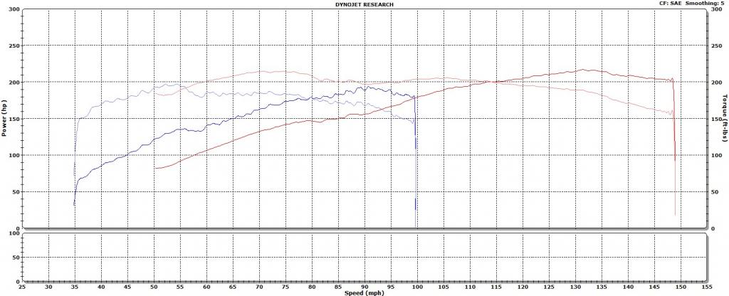

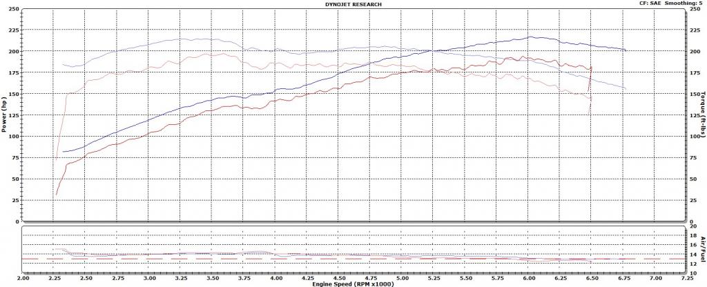

    So I've been going to the dyno fairly regularly to keep tabs on the changes I've been making to the motor. The last pulls in May were very encouraging as I was approaching 220 hp.
    I went back this weekend after some changes and was DOWN at least 25hp across the board!
    Changes:
    (1) Swapped Hall crank sensor and the conditioning board for a native VR sensor
    (2) Replaced dead-head fuel rail with a flow-through rail
    (3) replaced M50 throttle body with a 20% larger one.
    (4) replaced OBD2 cats and muffler with 2 1/2" exhaust, Borla center and Dynomax muffler.
    Here's the wildcard. The dyno was "upgraded" from a 2 wheel drive Dynojet to a all wheel drive Dynojet. The operator swore that it measured the same as the old one and showed a before-and-after with the same car and identical looking plots.
    So, am I really down on power or is the dyno the problem?
    Car feels fine. A/F ratios are fine.

              Matt at TRM believes that the chart is too perfectly symetrical for it to be a mechanical issue.

                      Plan is that I will verify each element individually. Fuel pressure. crank signal waveform and timing. Then I will take it to a shop that has the two wheel drive version of the Dynojet.
                      I will also mail the files to Dynojet for their opinion.

                        Would this make a difference (different gears!)?
                        • justin_l_
                          • Jun 2007
                          • 1079
                          Different gears as in different gears for the pull?
                          I have seen that cause different results first hand.
                          • Mike The Bavarian
                            • 488
                            that would make sense...if you dynod and only ran it in say 3rd gear and your max power was around 220ish then say if you dynoed in 2nd or 4th it'll be pretty damn different
                            • e46s54dr
                              • May 2008
                              • 1059
                              I've also heard that using different gears and rpms on the dyno will give a slightly different read. Dynos are like science experiments, it's best to keep the control variables controlled or close as possible to get the most accurate reading.
