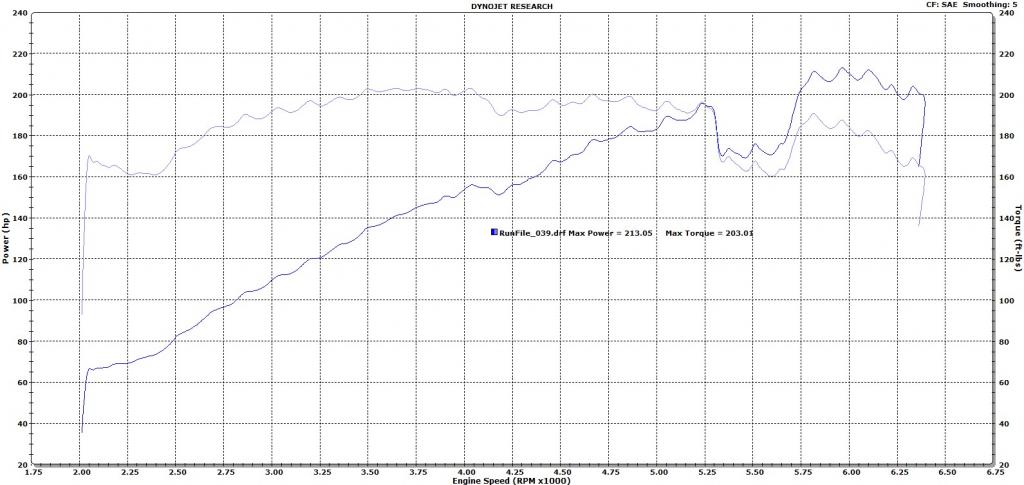

            I went back to the same shop for a "re-do". The first run with the wheels off the front roller were completely normal and I knew instantly that had been the problem. The drums were still linked, but the front drum was spinning by itself.
            I got some good data with different cam profiles including a very unexpected result.
            Kids, DON"T DRINK AND PROGRAM.
            I got a weird glitch on two of my runs but knew it wasn't the dyno because I could hear my cams slamming back and forth. I had a discontinuity in one of my programmed intake cam profiles so that the intake cam went from full retard, to full advance, and then back to full retard (40 degrees each way).
            The waviness of the lines is because of resonance in the belt between the front and rear drums.
            The dyno captured it perfectly!
