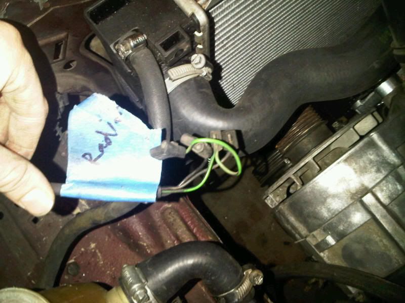

    Quick question, I have this plug from my 1984 318i chassis, on the driver side:

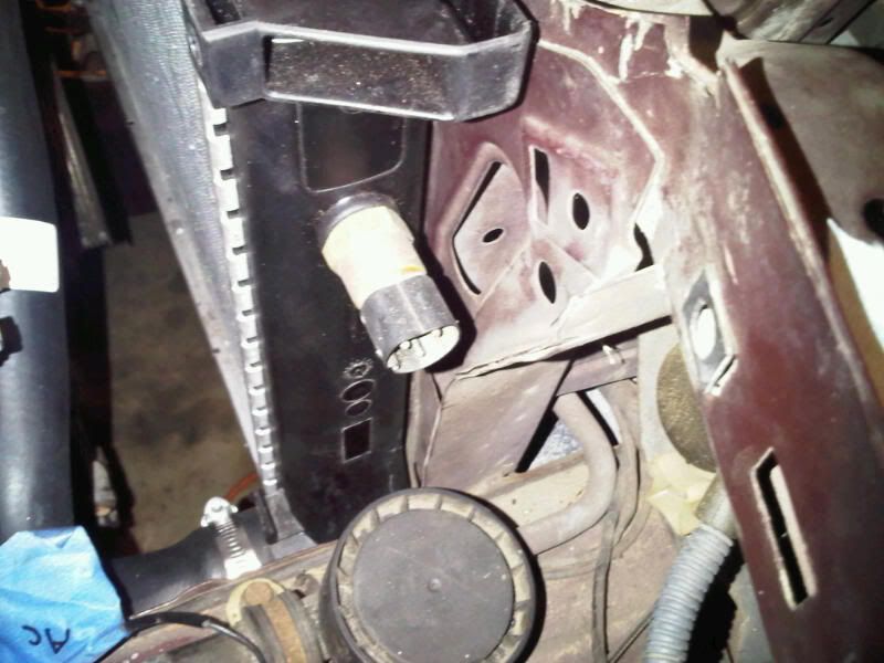

    and then the sensor on the passenger side:
    Am I supposed to connect them?

    Yes sir. Aux fan wiring right?

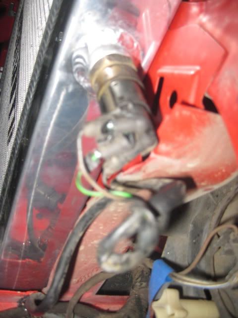

        Temperature switch, I think it is called. Thanks samiam, so wire it:
        Brown--------- Black
        --------Green--------
        I have a hard time seeing it from the pic.

          Brown is the ground, green and black are the signal wiring. Connect brown to either green or black with the key on and your aux fan should turn on. Since you swapped radiators, it looks to me like you need to get the pigtail from a late model, I think the wiring matches up.

                  From the wiring diagram that I have, you should have 4 wires. 2 greens and 2 blacks. 2 blacks are signals. the 2 greens are hooked together and hot! not ground! To hook it to the rad switch, you need a matching 3-pin pigtail. The black wire with brown stripes goes to 3 and pure black goes to 2. Any green goes to 1 and you can disregard the other green.
