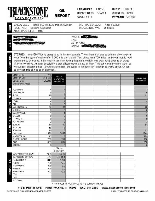

    I took an oil sample and sent if off to Blackstone recently, oil only had 700 miles on it so I expected it to be clean.
    Report shows that my air filter was dirty, relatively high silicone (dirt) and iron.
    I have a generic cone filter that I thought was pretty good. Took it off to measure for a new K&N, banged it on the workbench a few times and had a nice pile of grit under it.
    The 1% fuel is explained by the fact that it's been really cold, lots of rich cold-starts and short trips.
    Needless to say, a new K&N is in the mail. Edit: Also a Honda S2000 air filter. They are OEM paper element cone filters.
    Check your cone filters!
