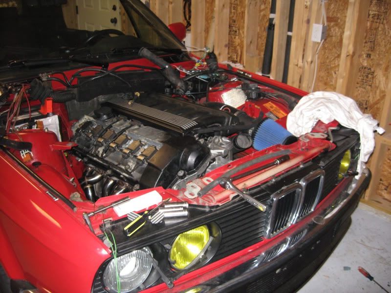

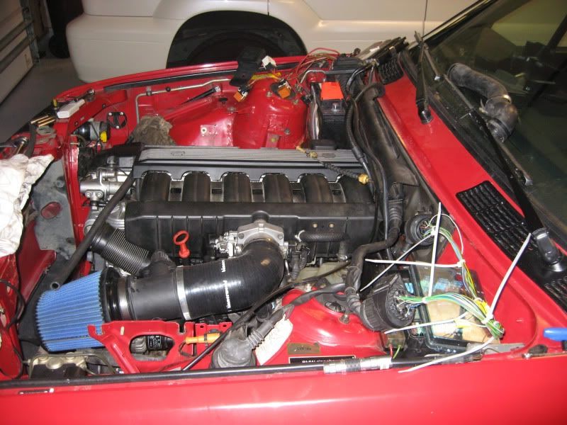

    Originally posted by e30rapidic View Post
    quick photos of the install in progress. It's not pretty but its functional. The wiring harness will certainly be cleaned up, no way in hell will I leave it like that. Also the C101/X20 adapter will be removed and I'll permanently wire in a connector when its confirmed fully functional.

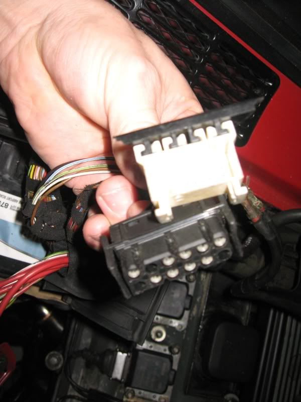

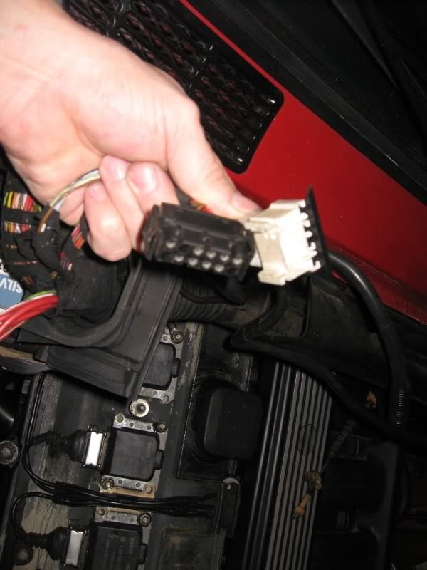

    Haven't sorted out what these two connectors do yet. I'm guessing one is for my mpg gauge and tach? recall something about there may be a C103?! connector under the dash for this? The other maybe a connector for the automatic trans? Still need to research.

    Tanke you guy for your picture, I'm sorry for my delay of this write. now my car have inside the s50B32 whit zf manual. Now i startin to understand to electricy plant of circolat connector of motor, I see in yout picture that you have find the all cable. Please , can you show the descriction for PIN ? if you will give that , i can turn on my s50b32 very easy. ciaooo
