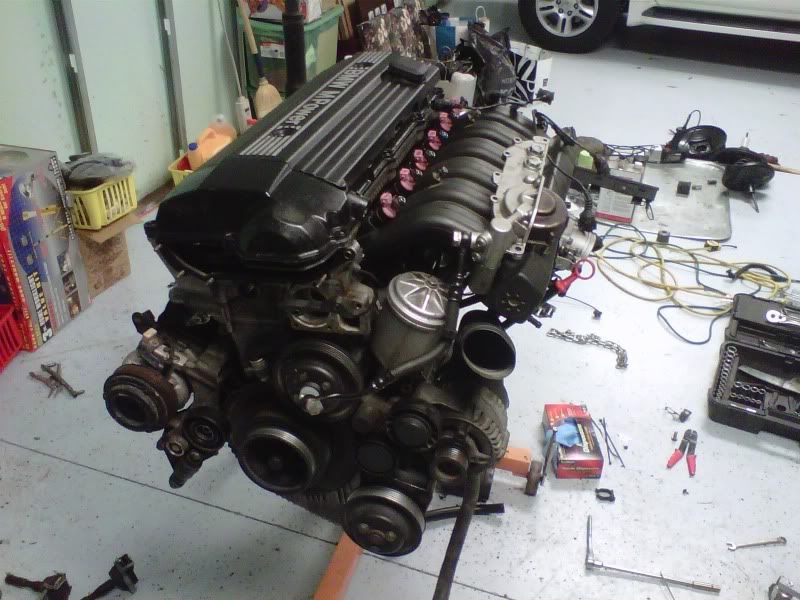

      engine has been completely stripped down and rebuilt....almost ready to go in the car!!! yessssss
      I am in a dilemma about what exhaust setup to use now. Thinking Raceland headers into the stock e30 system for now?!?!?! I hope to turbo the S50 as my next project...so will go full custom then.

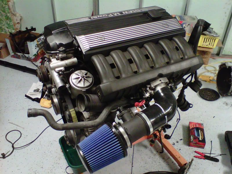

                  Well the motor rebuild is 99% complete!!! Have to finish up the vanos rebuild and then it can be buttoned up. I'm waiting on my lightened flywheel to come in before mating the trans to the engine for the drop in. I scored and picked up a zf trans for $99 out of a 328ci!!! So that's going in with a short shift kit. Switching out the 4.10 for a 3.25.
                  Will be running the pink top injectors and 3.5 MAF, with that I decided to run the TRM tune and picked up a bimmerworld silicone intake boot. Just placed an order for raceland headers, the rest of the exhaust will probably be e36 midpipe and magnaflow muffler. Using a Porsche 944 brake booster and M42 radiator for the integrated expansion tank. Hopefully a handful more work hours and it will be running. I'm really anal about it so will have all the wires, clips, holders and stuff in place and hidden properly. Eventually I will sort out the AC hose adapters so I'll have AC to keep the wifey happy. Hoping for 270ish hp. Starting to get excited......
