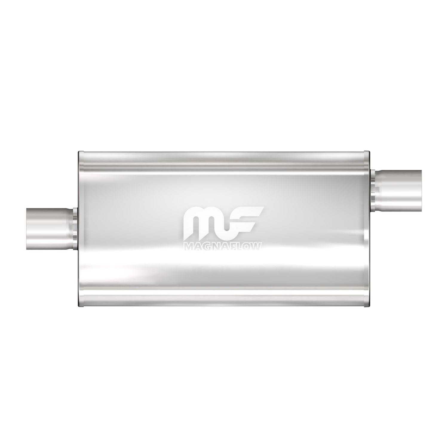

          OK, everything sounds good, until the last part of your exhaust. To connect a single 3" pipe to a 2.25" pipe, you'd just be introducing a flow restriction.
          If you want to run dual tips, get a reasonably sized 5x11 muffler (example: Magnaflow 14589), and get single in, dual out aftermarket exhaust tips. They have nice and shiny ones that look expensive. You will most likely have to get a 2.25" inlet tips and chop off the 2.25" pipe, and carefully modify the remainder of the Y to accept a 3.0" OD exhaust pipe. Fitment will be tight with a 22" long muffler like a 14589, but it will be doable if you chop the muffler inlet and outlet a bit.
          Another tip: If you plan on going turbo, and using a 3.0" turbo-back exhaust, you should place the header y-merge right behind the headers, and negotiate the transmission tunnel hump with 3.0" pipe. That way you won't have to buy two more 45° 3.0" bends later on, which aren't super expensive, but still cost some money especially in stainless.

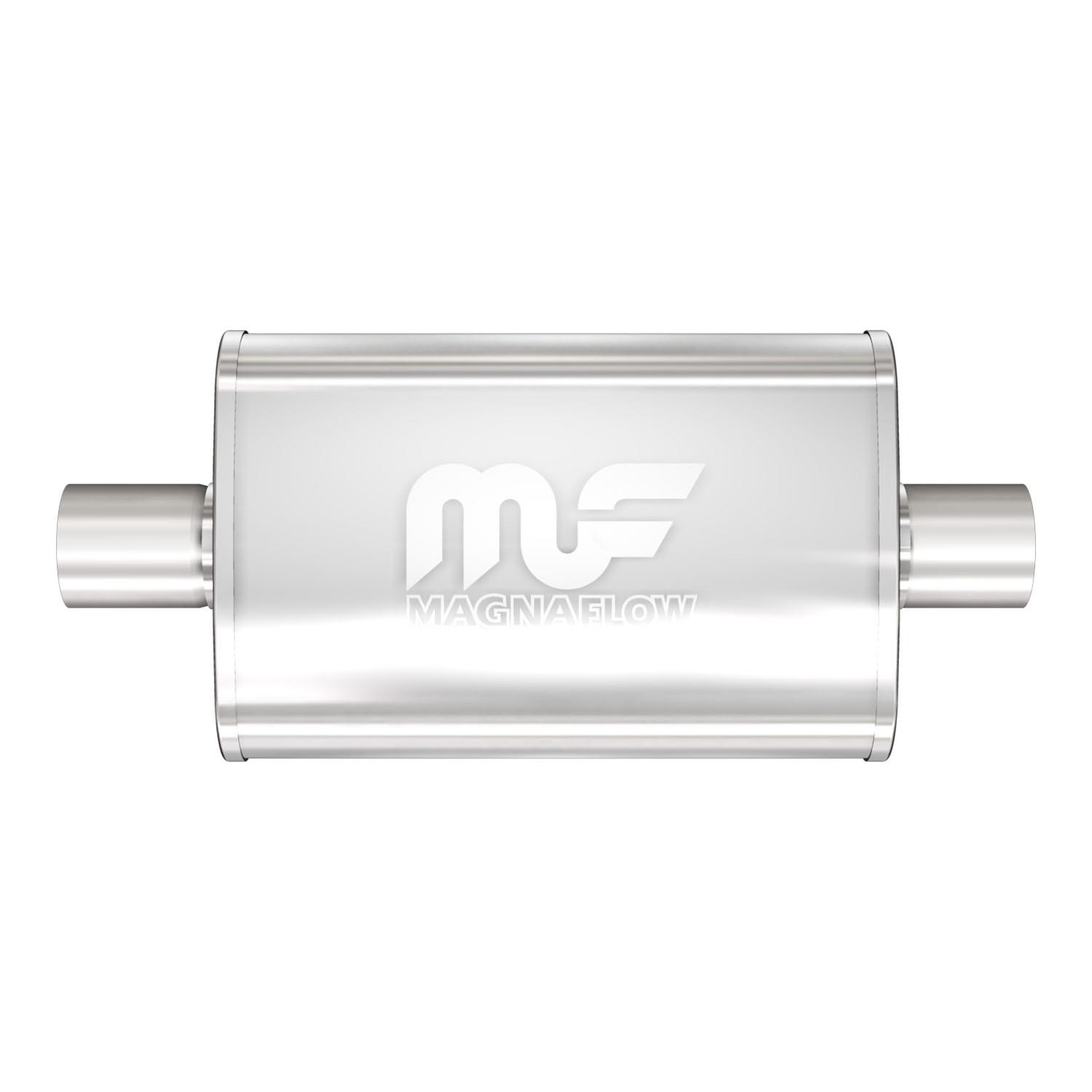

          I agree with you on the muffler I liked, it was just plans at the moment. I like the one you listed, but it has an offset bend. I was looking for a straight through. So I searched for a bit, results:
          I will just buy this one:
          (Part #11219)
          Free Shipping - MagnaFlow Performance Mufflers with qualifying orders of $109. Shop Mufflers at Summit Racing.
          It is 8"x2" smaller and cheaper(not polished) I am painting everything black.
          Here is the one you listed to compare, everything is the same but the design:
          (Part #14589)
                Internally the 14589 has an angled pipe. It is still "straight through", however, as the pipe remains at the same size throughout the entire can, and is a straight shot between inlet and outlet.
                It won't make a difference one way or the other; you might get slightly more clearance to the axle halfshaft by choosing an offset in muffler.
                For better pricing on Magnaflow stuff, there are some Ebay vendors that have a "Best Offer" option. I got $20 off MSRP on my muffler with free shipping.
