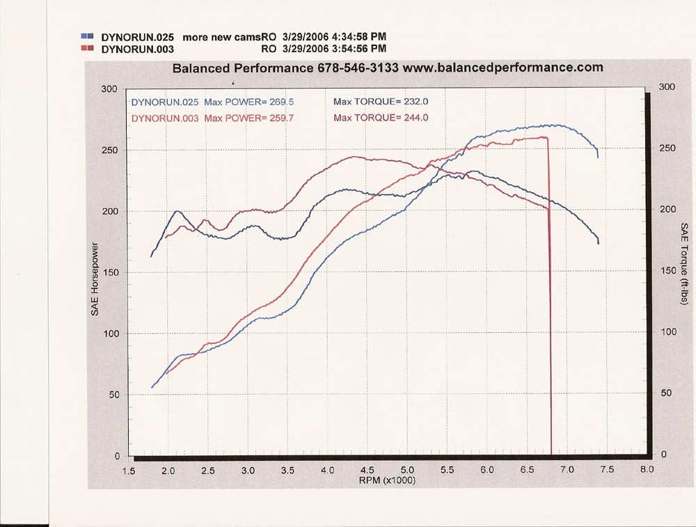

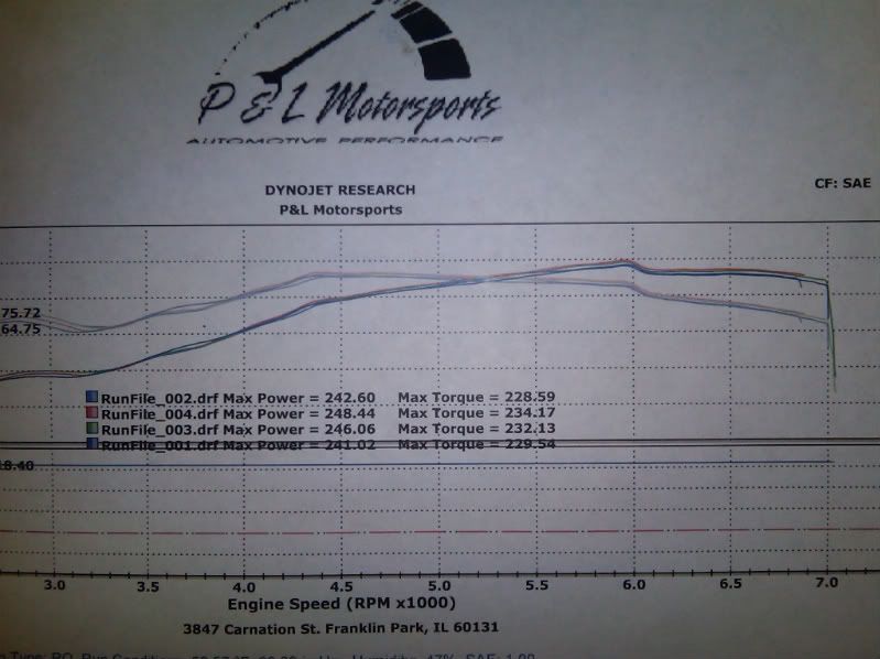

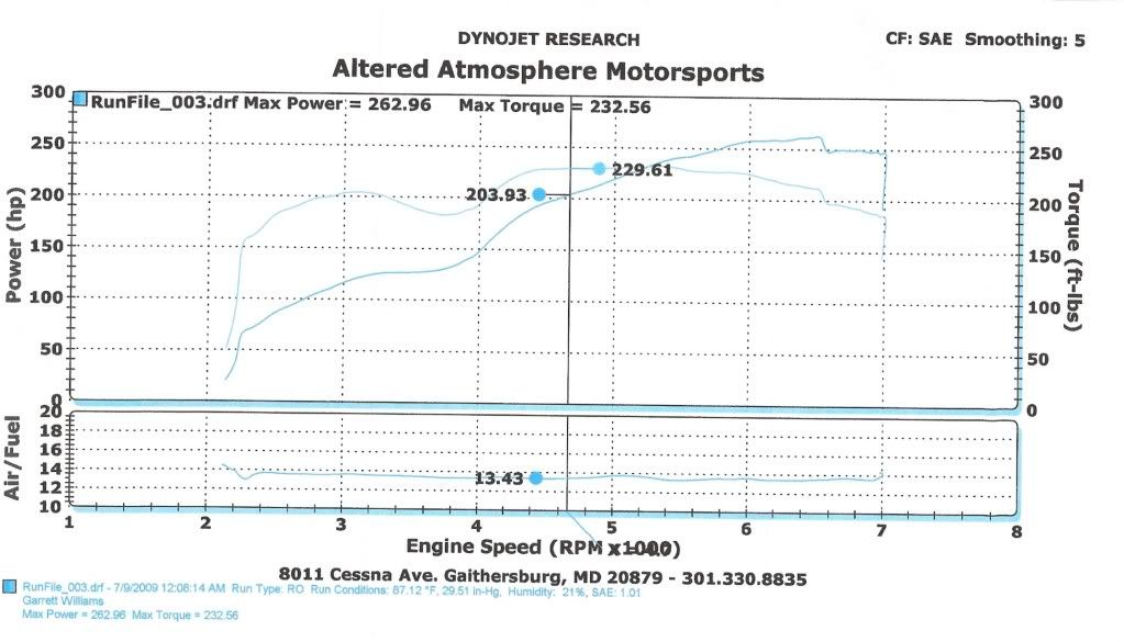

                  please, share the dyno sheet of a 300whp S50. It must spin up to 8500rpm to keep the VE up high enough?
                  we all know dynojets are optimistic.
                  and naturally, you're still using correction factors pulled from thin air to arrive at your 300hp crank with simple bolt ons. If you had an actual engine dyno, I'd be less skeptical.
                  Correction factors, sure. What you can tell is that, for Chris's car at least, he went from 207whp to 245whp, and when you consider that there is a 15-18% drivetrain loss, that is more like 50-60bhp at the crank increase over stock, putting the engine in the 290-300bhp range. This isn't rocket science: take the delta from stock to modded, multiply by drivetrain loss figures (240bhp->207whp stock, hint: 16% loss), and wow.....pretty clear. Add tuning for the mods and the 245whp would undoubtedly go higher.
                  As for the 300whp curve, take a look at the following dyno. The motor has Shrick cams, lightly ported head (didn't do anything vs non-ported head, look at 2nd dyno), Conforti Eurosport OBDII cam S/W, KK headers, AA race exhaust. The only change on the Evosport cam runs is the Evosoprt cams.
                  WITHOUT tuning or playing with vanos limiting or cam timing, it pulled 290whp. WITH tuning, the IP guys are making 300+whp.
                  And to quiet you guys bitching about the "ported head," here are TWO dynos of guys without ported heads, but with the headers/AA race exhaust/Shrick Cams/OBD2 S52.
                  Mods: Conforti/Eurosport Shrick cam kit, pullies, bbtb, intake boot, KK headers and AA race exhaust.
                  Look at the upper portion of the curve. Owner reports misfire, possible bad gas, but car was on its way to making 270 whp NA with the Shrick cams and NO ported head.
                  Same day, same dyno, different cars, different cams:
                  Shrick is red curve, Sunbelt SPORT is blue curve. You can also clearly see why it makes no sense to rev the S52 past 7000rpm.
                  Mods:
                  Shrick car: Eurosport Shrick Cam Kit, UUC Pulleys, UUC Stage 2 LTW Flywheel, AA Gen I headers, AA Track Pipe, AA Gen III Exhaust
                  Sunbelt car: Bimmerworld Sunbelt Sport OBD2 kit, UUC Pulleys, UUC Stage 2 LTW Flywheel, AA Gen 2 headers, AA Track Pipe, AA Gen III Exhaust
                  97 M3
                  Mods: 3.5" Afe intake, Porsche 3.5" MAF, US SS headers/mids, Stromung exhaust, 3.46 LSD, BBTB, UDP's, fan delete, OBDI Manifold swap, 24lb injectors, Shrick cams, Conforti software.
                  I think I've made my point. 300whp is possible from an S52 with proper tuning and cam timing, 260-270whp is the norm for a Shrick cammed car, 240-250 is normal for all other bolt ons. I've done seriously extensive research on S50 vs S52 vs S54, and the costs to not only swap one in an e30 but also an e36.
