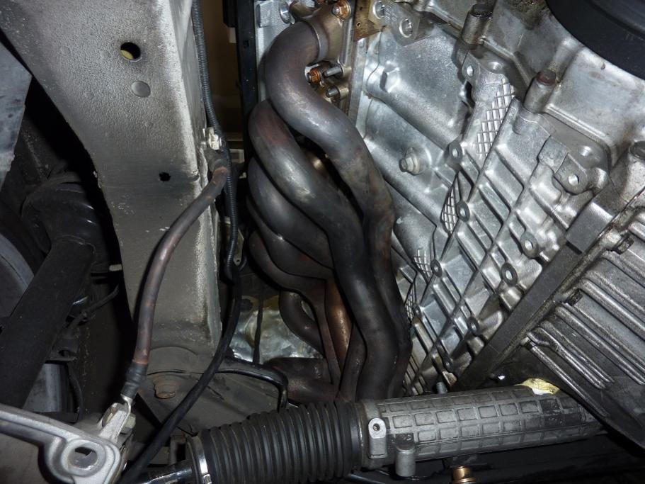

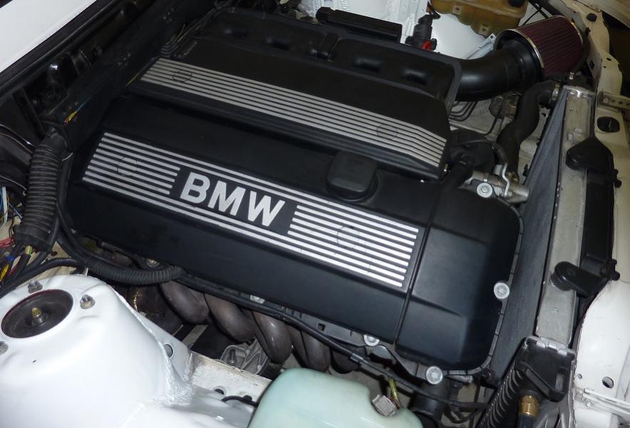

                      Here's what mine looked like when I got them. I cut and moved #6 runner about 1" to clear the firewall (firewall can also be massaged) and pushed the collectors up 1".
                      Fits like a glove now.

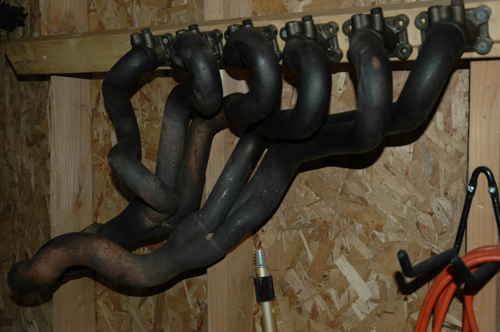

                          • bimmerteck
                            • 762
                            Originally posted by dreamchasin
                            what the fuck is that!?
                            It's euro headers they usually come attached to these. . .
